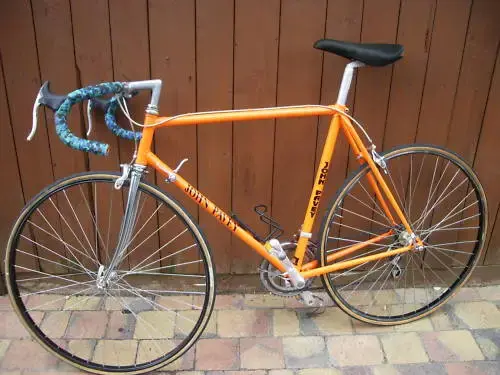

John Pavey up next
Heres the next one up.
Cool as a cucumber John Pavey.... almost done.... ain't going to be orange anymore though. I will start a new thread when this one is finished
Before anyone says anything about the angle of the saddle on the Pavey..... yes it is changed. This pic was taken as purchased. ha! ha!
