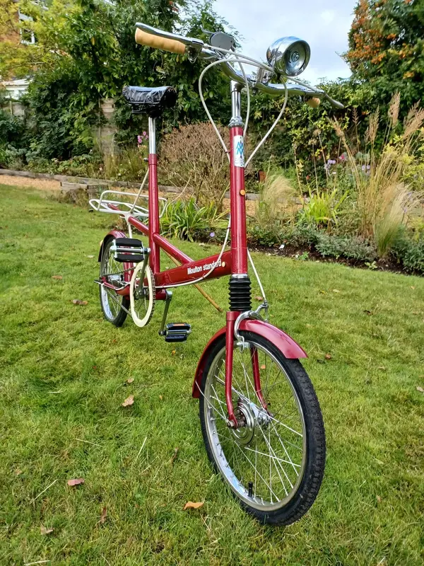

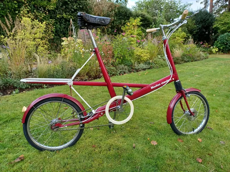

1964 Moulton Mark I (finished!)

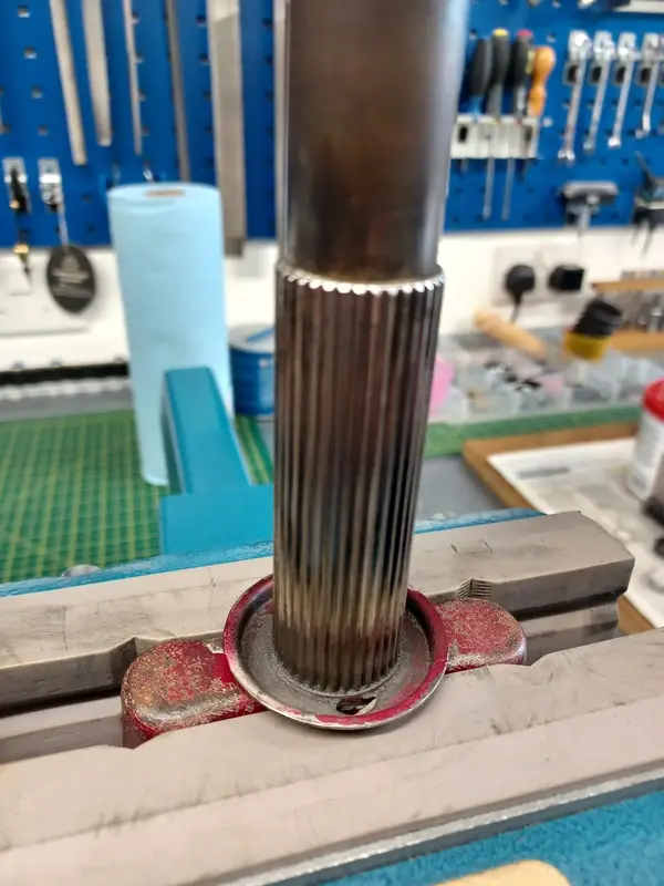

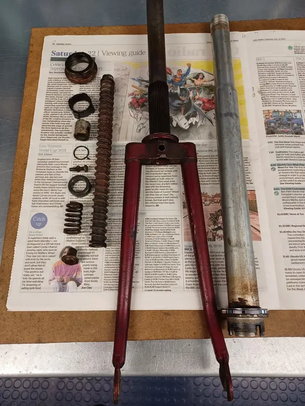

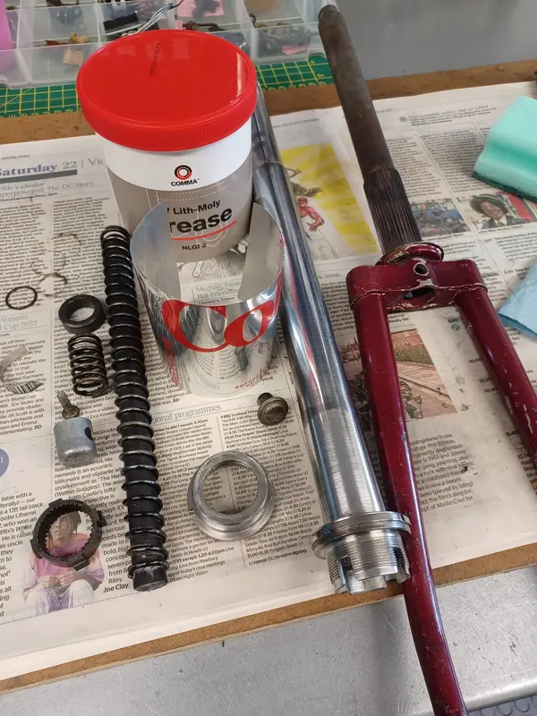

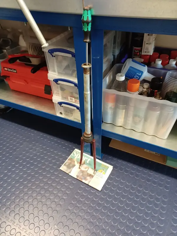

The suspension in the front fork is very clever, but it all only comes apart if you can free up a rusted bolt hidden deep inside the steerer tube. Putting it all back together then requires to fork to be inverted, two 2ft screwdrivers and an ability to balance the bolt on the tip of one of the screwdrivers whilst navigating it through a blind hole. Coke can required to shim the top nylon bearing to remove play.

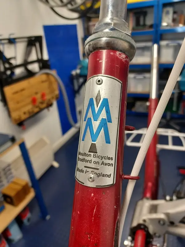

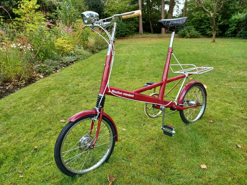

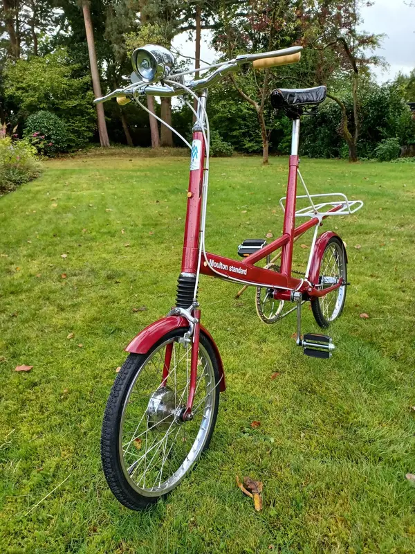

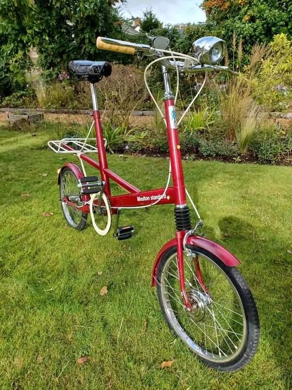

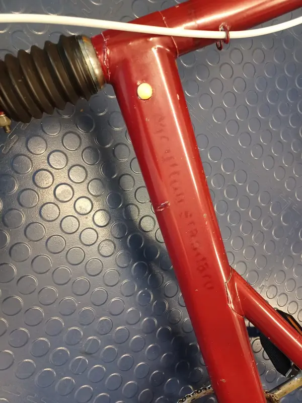

On the last lap, not in the home straight yet though… I could have done a better job with the head badge decal if I'd removed the badge and straightened out some of the dings in it, but didn't have any 2.4mm pop rivets and just wanted it done. I've talked myself into thinking the slightly distressed look is in keeping with the rest of the bike. Looks good from a distance though 🧐

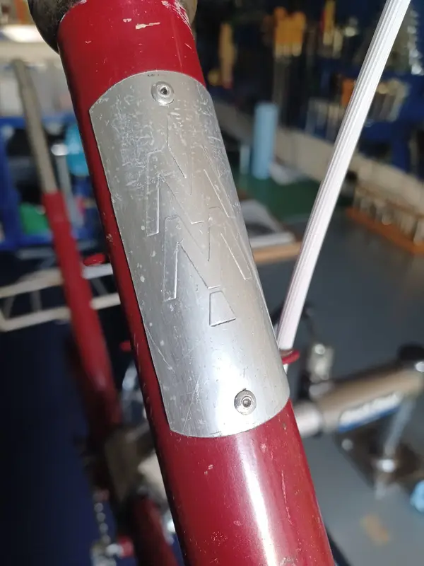

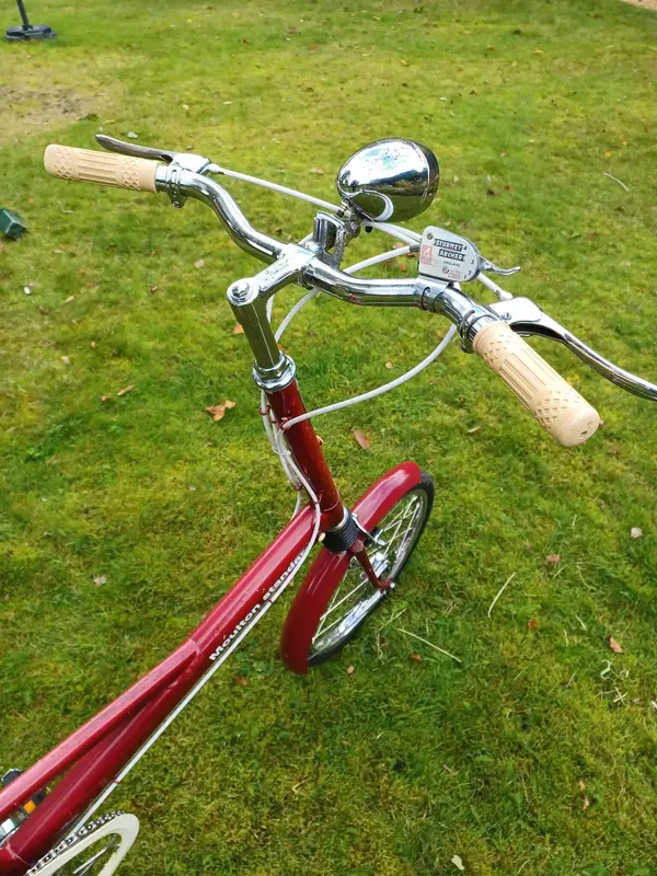

More decalling... The previous decals left quite a pronounced shadow in the paintwork which I couldn't really afford to buff out. The new decals were made up to be exactly the correct size to mask the previous ones.
P.S. the touch up paint splodges are not my handiwork. They are there to retain a bit of character though ;)

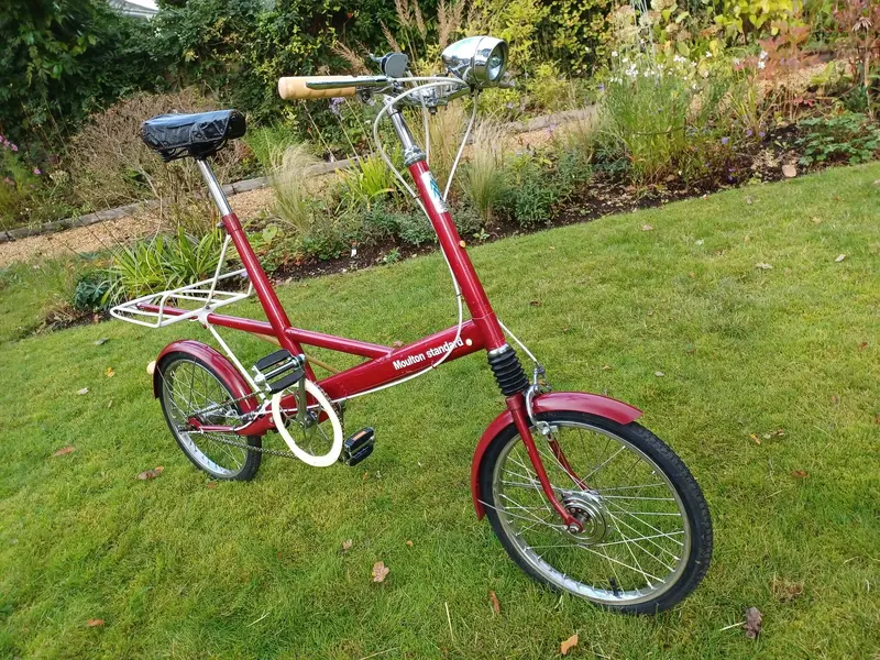

Back end coming together. Aesthetically I'd ideally like the wheel a bit further forward in the dropouts so it was framed in the mudguard a bit better. However the chain length dictated that it is where it is.

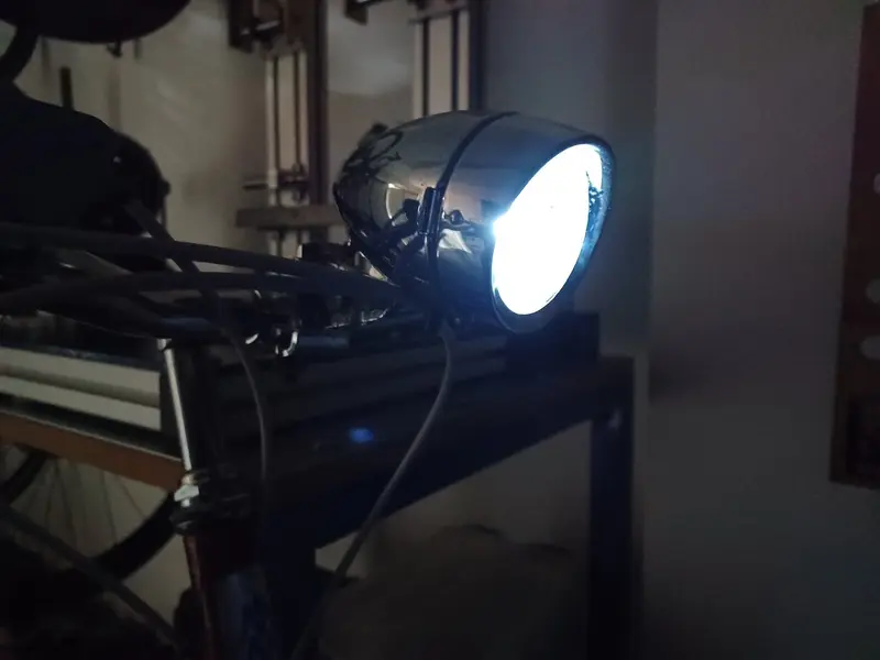

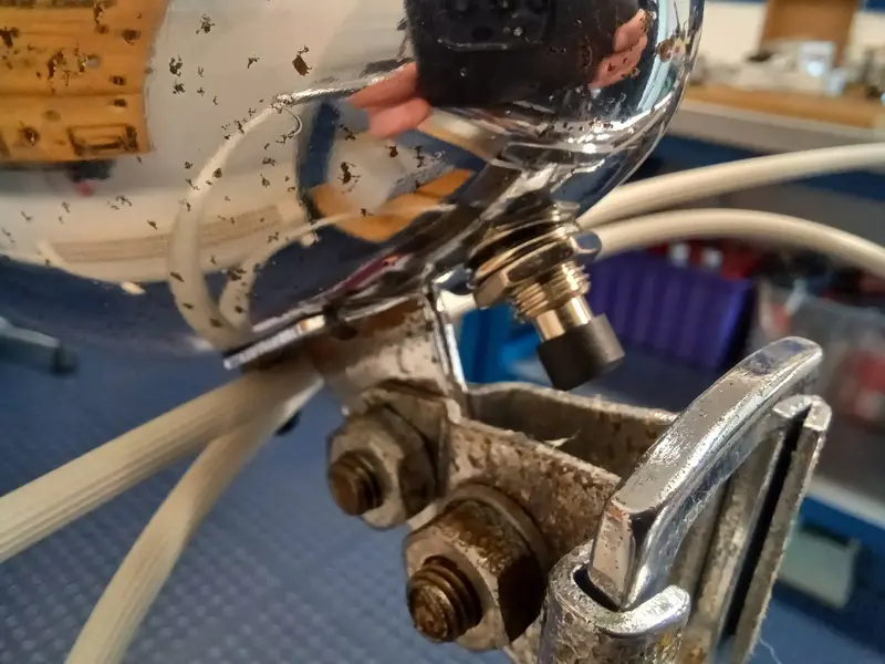

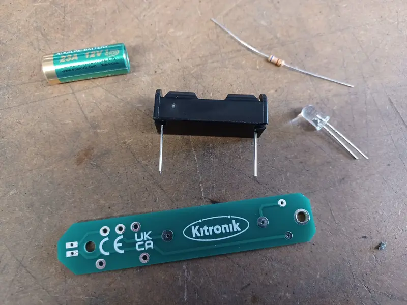

Rather than reinstate the wiring for the front light dynamo, I thought it would be fun to see if I could fit an LED into the lamp housing. I bought a small LED torch kit from HERE and wired it all up. I found a small on-off toggle switch which fitted exactly into the hole left by the old wiring at the back of the housing. The kit comprises a white 5000mCd ultra bright LED and a small 12V battery, so it reasonably powerful. Definitely better than the dynamo anyway. I think it looks pretty good.
