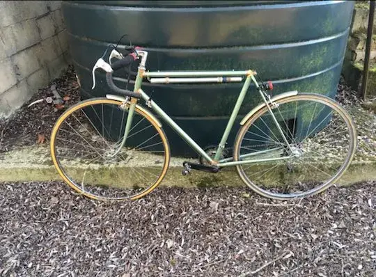

Picked this up last Wednesday, not sure the seller was the first owner but quite possibly was; given he's in his '90's!
Came with a 'repaint' - part rattle-can, part brushwork, no decals and a the headbadge had been painted in, in gold. Plus a modern-ish triple group and Kalloy post.

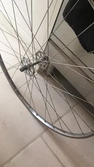

But the GB stem, nice shape but no-name bars, Weinmann redspot levers, 500 calipers, BB, headset, Dunlop Special Lightweight / Airlite hub front and the five speed block on the back are all in pretty good condition... so am going for restore with period groupset.

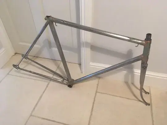

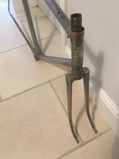

First job was to try and work out what I'd bought, so strip out and see if there was any frame stamps. Bingo. Matching steerer tube and BB stamp, five digits, confirmed by @dwscrimshaw on the Holdsworth thread here as 1960. Also, inside the tubes the original gold finish.
So, gold, 1960, Agrati rear dropouts, top-tube pump pegs - so possibly a Golden Hurricane. And if so, that'll need some Campagnolo then. Gulp.
Have now started hand-sanding. More news presently on plans for paint and parts.

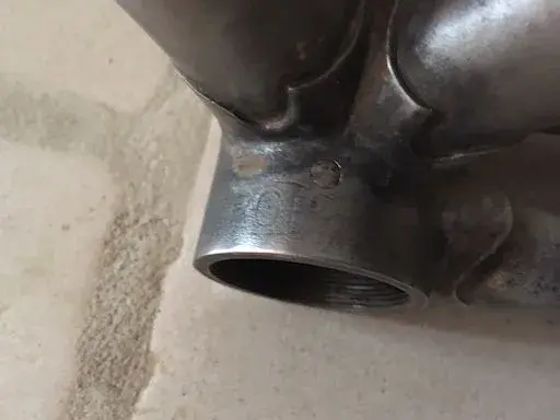

Hand sanding... phew. Hard work (I have time, less money :) Still, making progress and on the BB shell is a oval stamped mark with the letters 'RGF' or 'RGP' - anyone know anything about the maker? Also looks like it was drilled for another (cable?) fitting?
Ha!
""Raccords Gargatte Frères", or Gargatte Brothers Fittings. Bulge-formed. Highly regarded by many top artisanal builders until the investment cast revolution"
