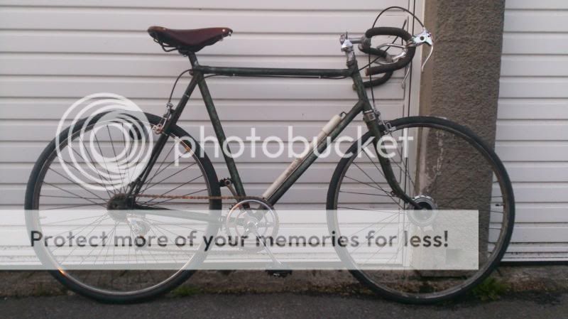

Progress....
It's rideable but not perfect...
And it looks truly disgusting.

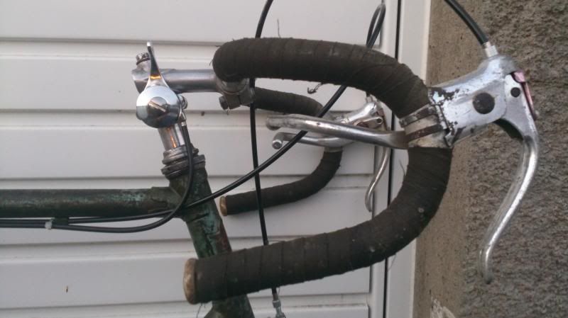

The bars, and brakes came from car boot sales. The bars cost £1 and the brake levers £5. the shifter is a motorcycle choke lever I had laying about. The brakes are off of a 60's raleight which was destined for the skip. The wheels are from the same skip. The front is a 26x1 1/4 dynohub. The hub still works! The rear is a 26x1 3/8 sturmey hub with a french gearset. The derallieur is a cyclo sourced from ebay. The seat post is modified to fit the 1 1/16 stem acceptance and the saddle is off of another bike I have.
and the pump was found in the skip!
My next decision is what to do with the wheels. Should I re-rim them as 700C???
Then I need to clean up the bars and re-tape and clean up the levers.

Because of the state of the wheels I took the decision to replace them with with modern flip flop wheels. I will restore the originals, but want a rideable bike for this summer!
Removing the rear freewheel assy from the old wheel was 'fun'. Had to strip the whole freewheel, then get a bar in the removal slots and gently tap it with the copper mallet.... 1 hour later it decided to move!!! Then found that the S/Speed freewheels use the same thread. So I now have a fix wheel on one side and a three speed on the other.
Replaced the crumbling bar tape with leather tape. Much better (and cleaner)...

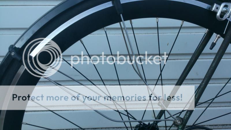

The went to fitting mudguards. Looked at the old catalog and tried to replicate the stays on the new guards.

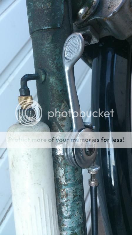

Also moved the gear lever to the down tube. I need to re-make the cable and remove the tape I used for routing..... but the lever is a thing of beauty....
