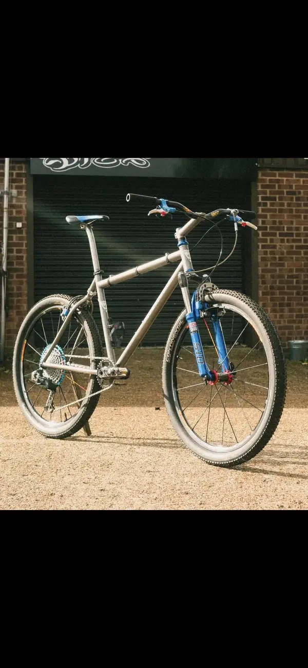

1 x 12 drivetrain upgrade 135mm qr axle details if anyones interested
Str33tf1ghter

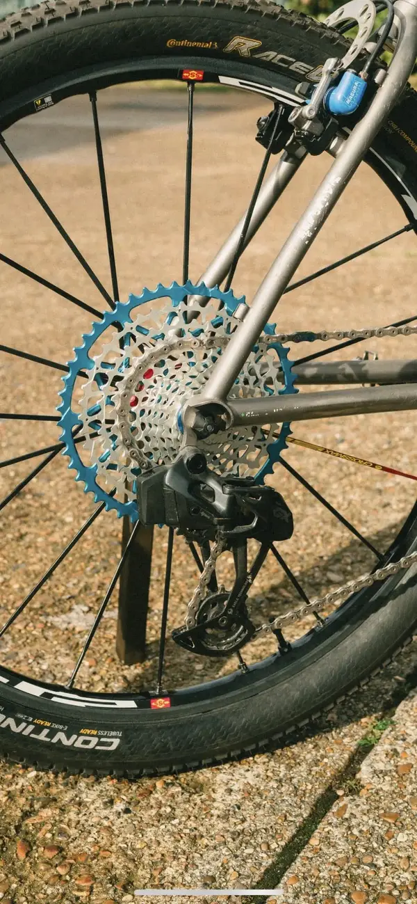

Changed my old Moots up to a 1x12 Sram AXS drivetrain, my biggest problem encountered was trying to get a decent and lightweight cassette to fit the 135mm axled HG 9spd freehub on these Mavic Crossmax SLR's, after much hunting I found a company, GARBARUK.com in Poland who make the most epic cassettes ever!!! , they did this 12spd Sram/Shimano compatible spacing 11-52 cassette that fits straight to a std HG freehub , no mods needed bolts straight up!!
So far soo good, 1 x 12 is amazing, just a note too, the whole cassette only weighs 330grams!!!! its an amazing bit of engineering!! running a 34t up front as well.
IF anyone's 385545067_365837839455889_6270785394319236285_n.jpg 368012745_363661059399002_5664324987971317128_n.jpg interested the whole bike weighs 9kg
:oops:£300:oops:
