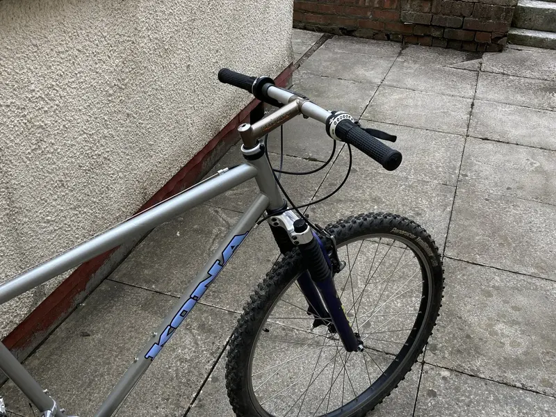

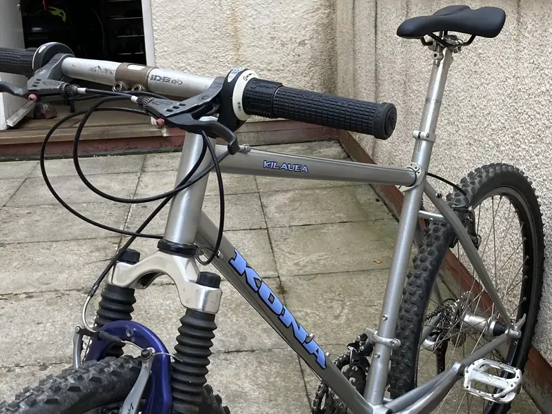

I recently picked this up off eBay listed under an incorrect spelling of Kilauea. I already have a retro MTB (a Giant Boulder 500) and don't really have the space to pick up another, but I've always loved the shapes of these classic Konas and couldn't turn down this deal!
The plan with this bike is unknown, but I am definitely going to ride it a lot once it's set up to my liking, have no fear. The paint job isn’t original and is missing a few decals. It’s shoddy in some spots so I'd like to redo this at some point. The frame/decal colours aren’t stock for any Kilauea but I really like the combo so would repaint it the same, but to a higher standard with all the decals in place (drive side doesn't even say 'Kilauea'!).

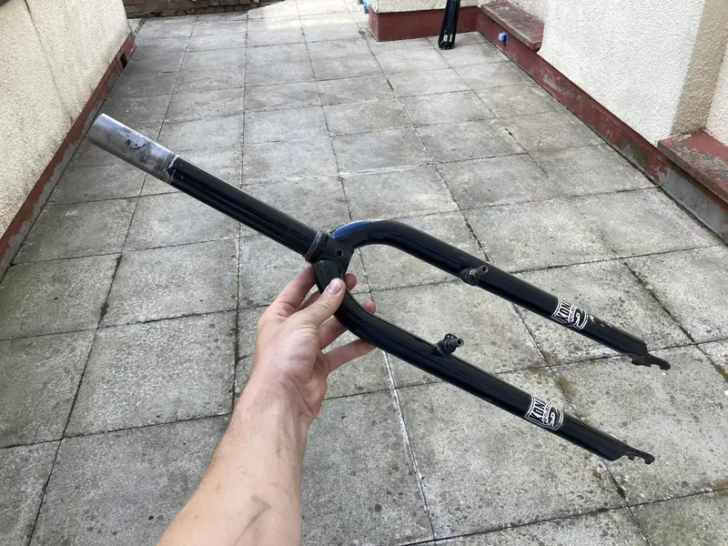

I managed to find some Project 2 forks for a good price on Gumtree and they’ve arrived today (it’s like Christmas in my flat). It turns out they’re threadless though, so having to decide what to do with them. They’d drop the head tube back down 50-60mm which is more true to the original spec, they also look fantastic so keen to make it work. I love the skinny velocity stem look, but going threadless opens up a lot of cockpit combinations for me. A lot of Konas on the site are still threaded, and I can't imagine how the bike will look using a different cockpit. If you have converted yours to threaded I'd like to hear your thoughts!

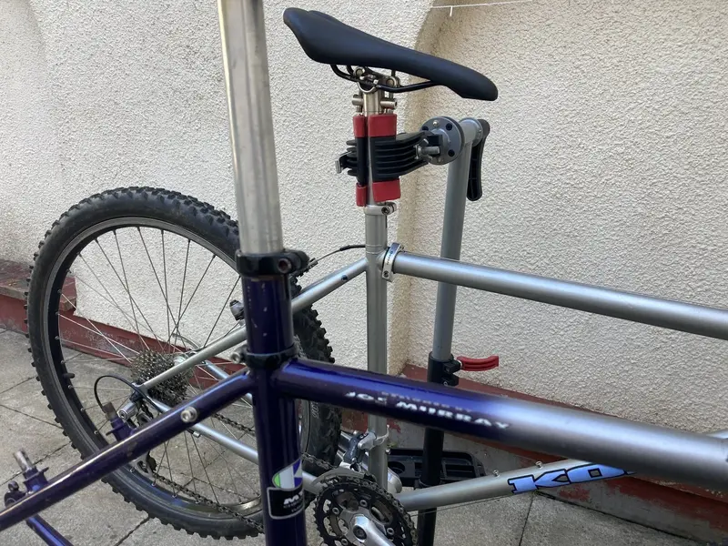

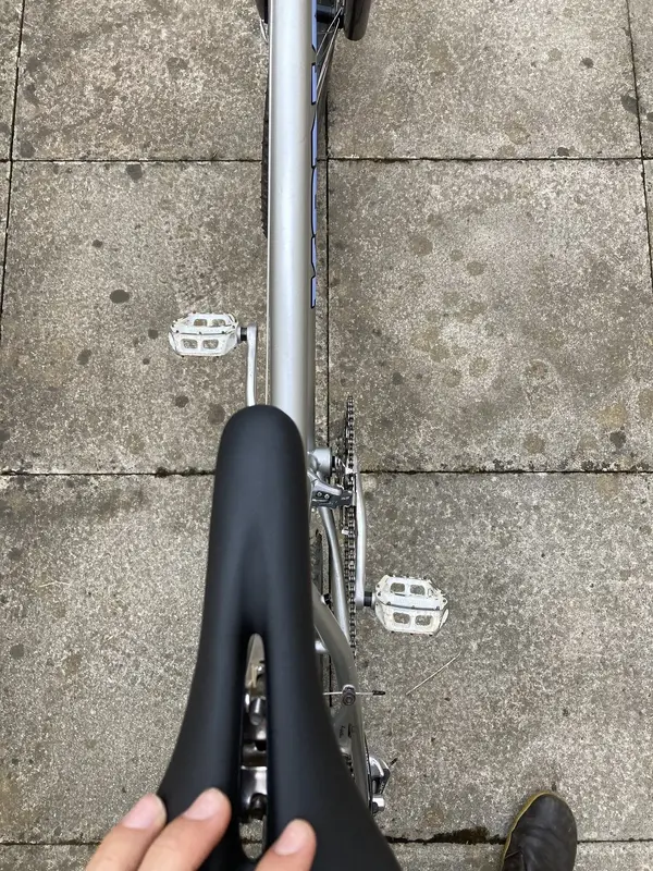

One issue I've discovered so far after a brief ride around the block is that the DS crank arm is either bent or installed wonky. It's hard to tell, but it causes the pedal to rotate inwards and outwards as you ride. I'll get my hands on a crank puller over the weekend to check this out.

Very nice find! I've got a 93' and love it. Nice work sourcing a P2 so you can dial the stock geometry back in. I just checking and looks like Kona started using threadless on the Kilauea in 97', pretty basic looking stem used:
Plenty of fancier options, Syncros Cattlehead comes to mind.

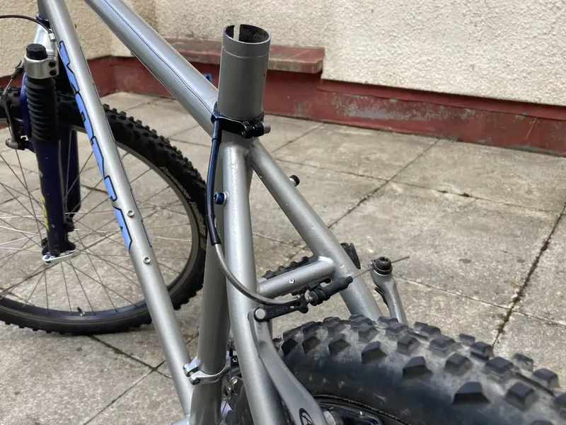

Be nice if you could source the proper rear brake cable guide but only if you plan to go cantys. At the very least possibly look for a single cable stop clamp if you stick with V's rather than the current triple with only one stop used.

Cranks removed today, BB buttery smooth and straight as far as I can tell. Held the rings against a straight line and could see that the crank wasn't parallel. New cranks on the list then!

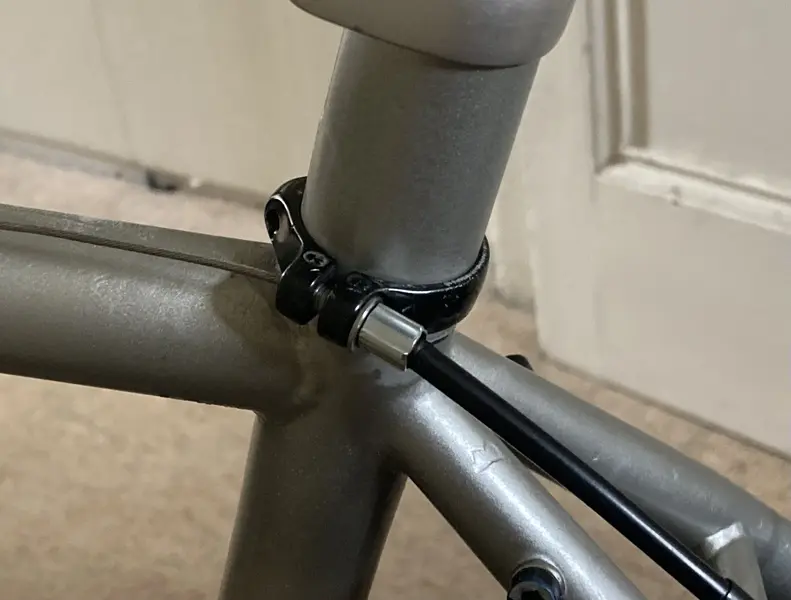

Regarding the cable guide, I misread your comment @Canuckbiker and got excited about the spare dog collar from a Fire Mountain I recently picked up from a jumble. Went to install and realised V-brakes don't play well with this style of guide. Trawled the forum for some potential solutions and came up with this temporarily. It barely works, if anyone has a better idea let me know! Or if anyone has the right guide I'd be very interested.

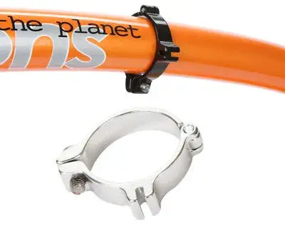

Looking much better to my eyes with the P2, regarding the cable stop, you could use one with a single stop rather than three, it’ll look cleaner, something like this

In a moment of genius (an MTBR forum post from 2004) I used a barrel adjuster from a derailleur as the bolt to tighten the collar, giving me a cable stop for the rear brake! A couple of mm off the housing and the brake works great. Without fully tightening the collar, pulling on the brake actually self oriented the collar to it's correct working angle. Very chuffed.

Haha, I made this mod to my '94 lava dome back in '96/'97, when I fitted a set of original xt v's.

How long is the steerer on that P2? I've a couple of 19"s and always look for 200mm to be safe

Brilliant! The brake guide mod is good, although looks a bit sketchy up close. I might have a look at 3D printing an alternative, unless there's something cleaner on the market.
The P2 has 220mm of steerer. With a 19" frame I have a good amount of stack to play with while I get the position just right! Which leads me on to my next post...
