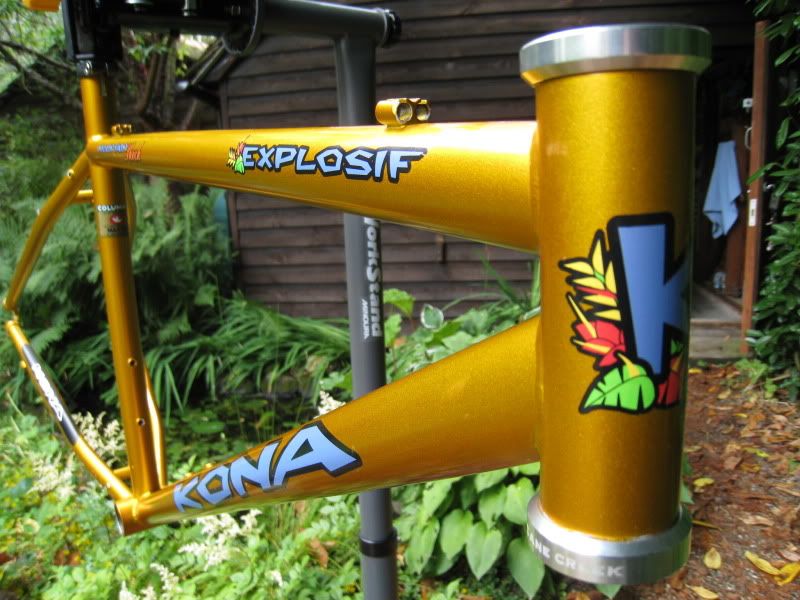

My first 'contribution' other than buying and selling :LOL: Thoughts and comments welcome as I'm still working on the overall 'look' :?
Like I could swap the silver bars for some nice black Taperlites I have?
XTR chainset or Middleburn with silver arms, black spider and silver rings/black bolts?
Bought the bike a few weeks back from 'meeeee' on the forum - cheers :cool:

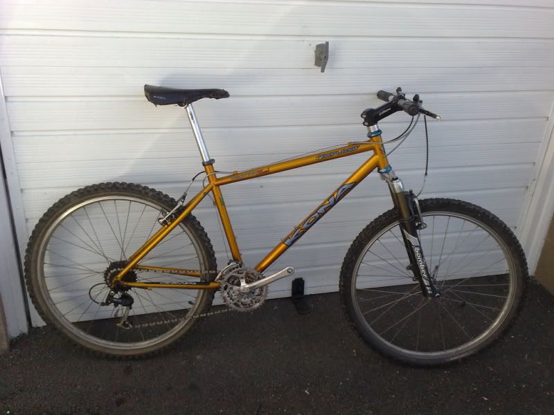

As it was...

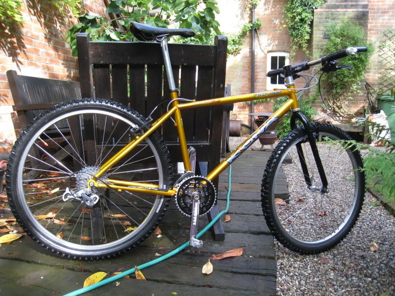

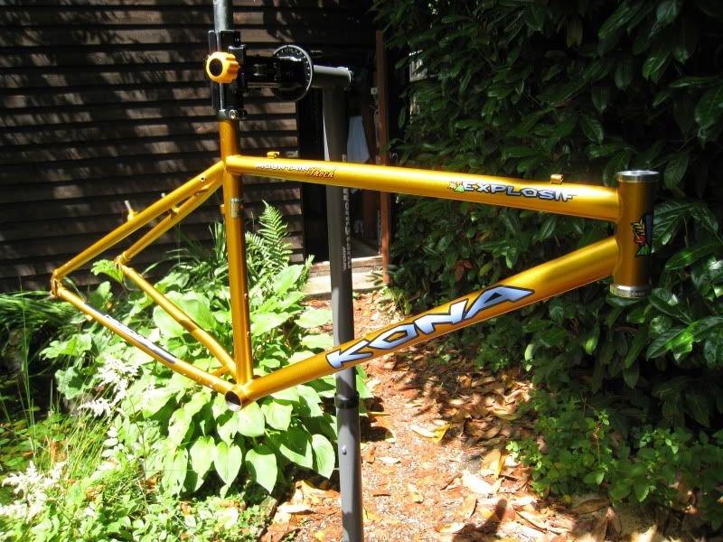

I stripped it down and gave it a good clean and polish and fitted a new headset...
I'd been aquiring parts for a while and got most of the assembly done...

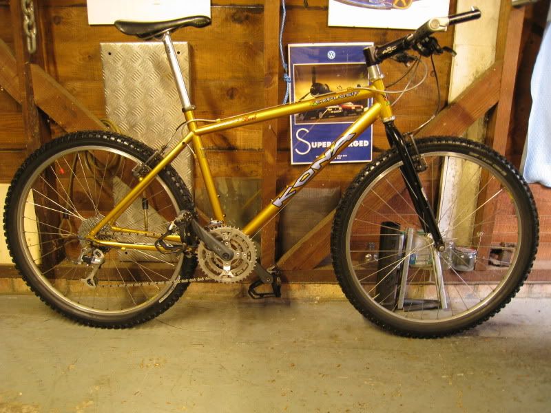

The XTR chainset and BB arrived so I fitted those and finished off with cables and the chain...
I'm now looking for a few other bits to get it how I want it; XTR M950 Rear & Front mechs, XTR Cassette, Black seatpost (Yeti/Syncros/Control tech) Black headset spacers, Black or grey skewers and XTR M951 shifters are on the way :cool: And looking for suitable frame touch-up paint.

Looks stunning, always think they look fast with the P2 forks, would look good with the Forks sprayed in the same colour as the frame?
Trim the neck you've created on the forks and put the stem where it should be.
If you need it higher then get new stem with some degree of rise and/or risers (shudders ;))
it just looks a bit silly...
Sorry that's my first impression apart from the front mech cable from the bars looks a bit long.
Over all liking the bike, and I think I prefer it with the RaceFace (?) crank arms on (though not the rings)
What's it riding like ?

Yes, it is a bit 'necky' but I do need (due to various health probs) to have the front a lot higher than I used to :( I do have a higher rise stem I might try, but I didn't really want to cut the steerer, we'll see! I'm not keen on fitting riser bars either ;)

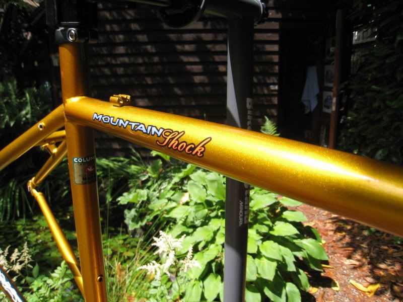

Oh and 'mountain shock' on the top tube means it needs sus forks...
(hunt for some xc600s...)
Ah, didn't realise that.
