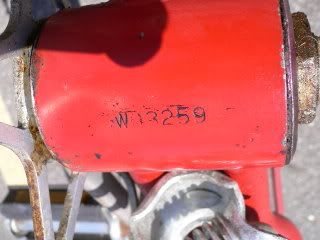

I picked this up off of craigslist. It's (I think) a 1938 Fleet (Schwinn) C Model based off the serial number even though the crank date stamp is 36. As many know, old Schwinns can't be dated definativly because the records were lost.

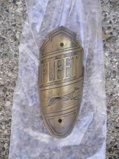

Headbadge:
Nice patina. The guy had a NOS one too, but wanted $100! I like this one better anyway.

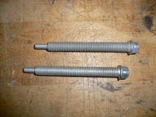

Axle Adjusting Screws

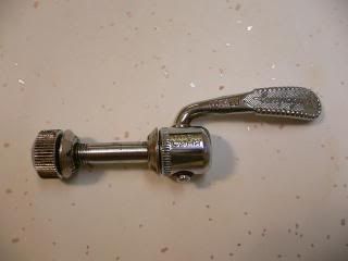

Campy Seat Post Binder

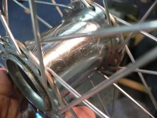

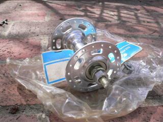

NOS Shimano BMX Front Hub

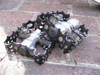

VP Bat Wingz Pedals: old stuff from the basement

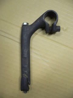

Ashtabula Motomag stem
for cheap. A little Eastwood Zinc Phosphate spray paint, and it will be stylin'. The $50-$80 for a decent one on the bay is out of hand.

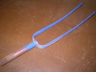

NOS Schwinn ballooner fork

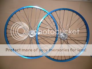

NOS Ukai wheel set. The front was built with the hub above and the rear was already laced back in the 80's with a Suntour coaster hub.

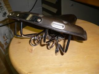

1983 Brooks B72. I really wanted the chrome instead of the newer black style.

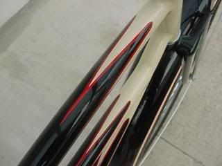

- Prep for a paint job like this but with blue pin stripes to coordinate with the Ukais

I understand they are largely decorative, but every bit probably counts on these old forks. I just like the look. Although the tubular BMX style like Dr. S is equally cool in my opinion.
I chose a postwar forged fork for more strength and haven't decided if I'm going to add a locating bracket for the truss rods at the bottom of the steerer tube or not... right now, thinking not.

Fork and truss rods fit ok. Just need to cut down the steerer tube 1/4"

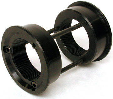

But the BB doesn't fit at all.
Dr. S, what did you use?
For now I'm thinking:
TruVativ American-to-Euro Conversion kit - $22
IRD 68 x 103 mm Bottom Bracket BB102 - $30:
