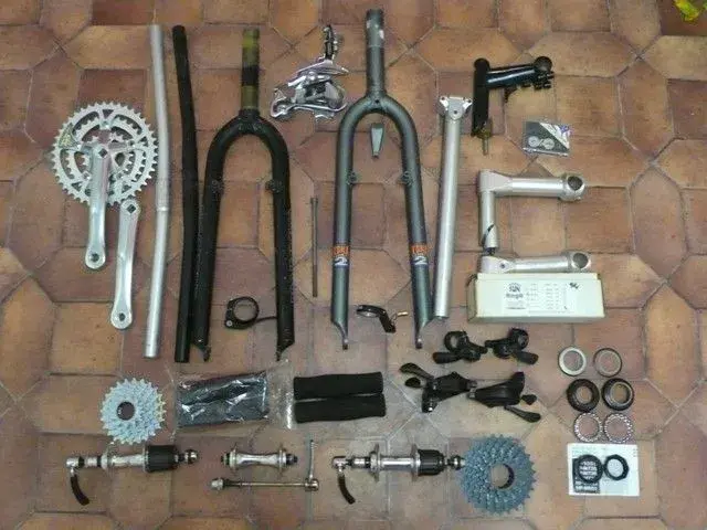

It's possible that you have a XC Pro MD hub as the freehub is smaller than the standard, I have both at home, the MD uses the 6th and 7th sprocket to screw in and the normal uses just the 7th.
If you have the hub part no I think you can check on First Flight bikes.
Cass
In this pic the two hubs at the bottom are Suntour XC pro, the one on the left is the normal and the one on the right is MD, you can see the difference in the size of the freewheel, the silver cassette is a 7 speed MD cassette and the black one is a standard 7 speed cassette. Hope ths helps a bit.

Ah! I think I have the MD one then,,, anyone want a swop for a normal.. :LOL: or going to sell me one to fit ?
thanks for your help fellas. thought I was going nuts.. once again retrobikeguys bring there wealth of knowledge togeather.. cheers...
Looks like its going to be another few nights searching again for another cassette... doh!!
Si
I have difficulty with had removed much the spocket of my cassette Xc pro. If you have the same one as that in photograph (uniglide) the 2 first are screwed but with time it are almost welded ...... I put much time and force to remove them.
