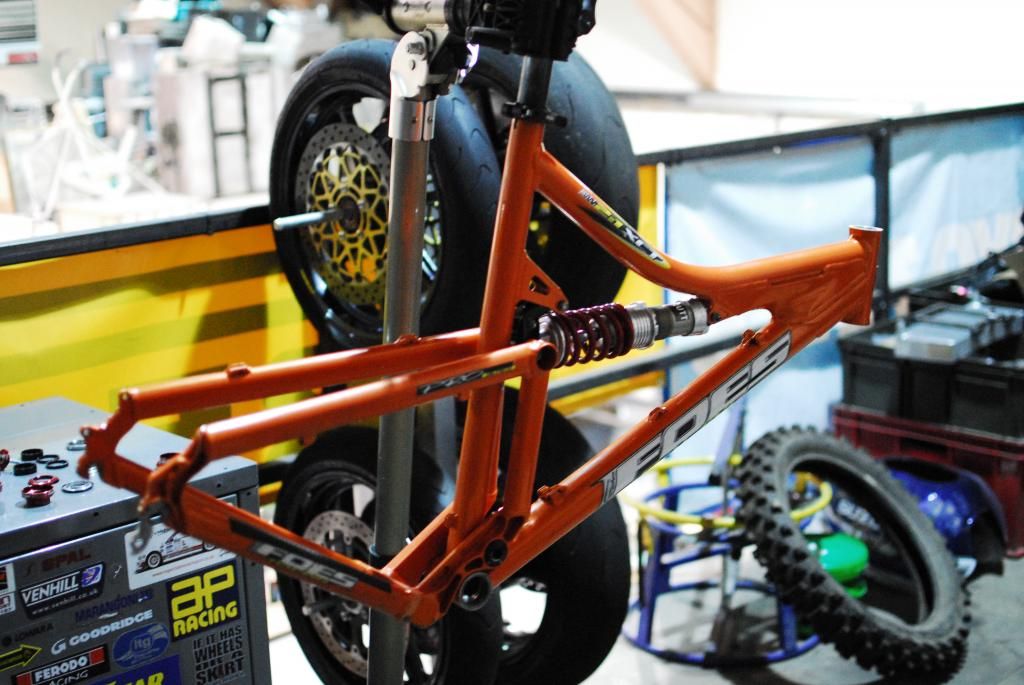

I bought this in a private sale after seeing a listing on ebay. The deal included some raceface cranks and a seatpost, I suspect I will move them on just now. I built the bike up for now with donor parts from a couple of my other bikes, and will upgrade to more suitable parts in time. Most of the parts are from my Cotic :- http://www.retrobike.co.uk/forum/viewtopic.php?t=119688&start=0 The forks i have fitted, Reba rlt's are a little short and this puts alot of weight on the front, this is the first and most important change i need to make.

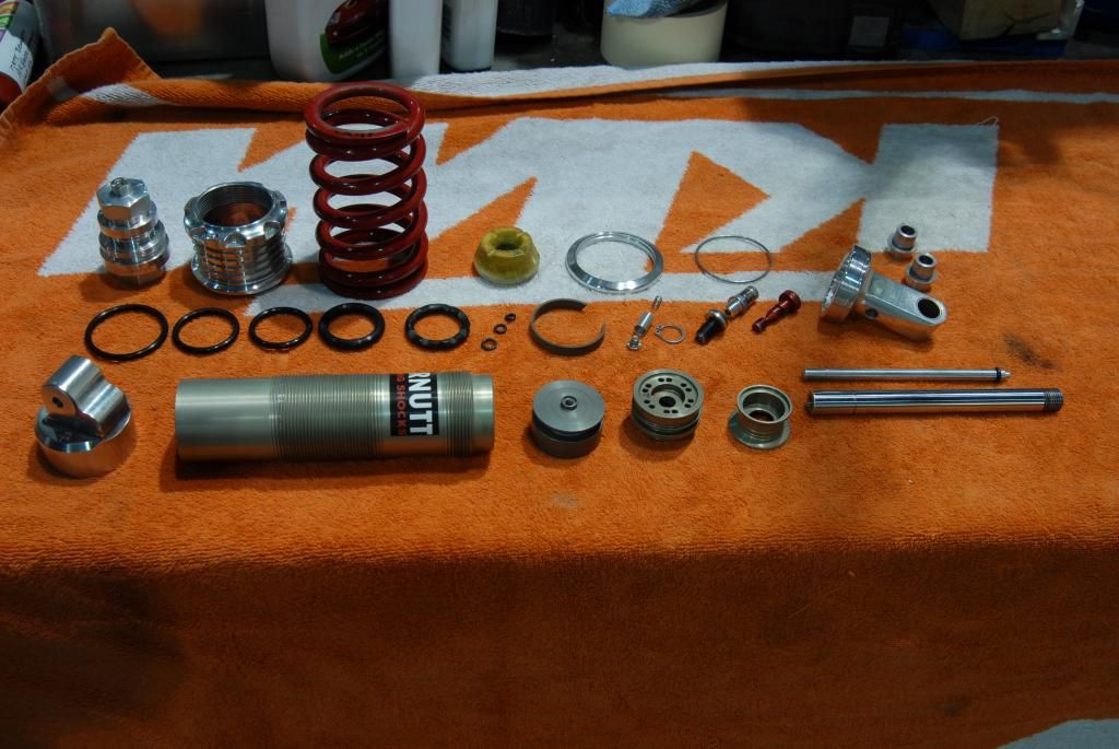

In the meantime i have stripped the Curnutt shock as the rebound adjuster didnt seem to make any noticeable difference. upon stripping it i found that the return spring had moved and was no longer pushing on the needle so the settling was stuck on full slow.
I made a call to the UK importer of the bikes to order a seal kit but they won't sell me one, apparently I need special tools to strip and reassemble the shock. Which I do have. I will try the italian importer to see if they are more helpful......
Failing that, I will have to source all of the different seals separately, but this shouldn't be a problem. Just don't fancy having to buy ten of each size.
