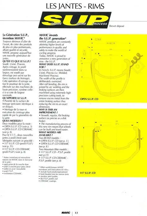

Thanks for that! Since posting I bought the rims anyway, and it turns out they're mach 2 CD 2. they do have "S.S.C. 93" engraved on them though, and MAVIC in large, yellow, individual letters, which I hadn't seen before. The joints have also been welded and sanded down, but not all round the joint, only at the brake track. The other pair of rims I have doesn't have this feature either.

The braking surfaces on the SUP rims were factory machined as in the page below. Not sure about the 'ordinary' rims.
The braking surfaces aren't machined, only at the joint where the rims were welded. I'll take some photos, which should explain it a bit better
