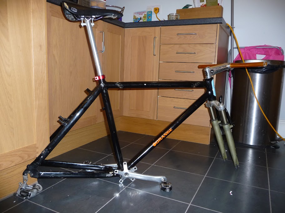

Ok so I bought brooklanders other frame as pictured by himself
Paint is well thick 0.5mm in plases and a tough as a plastic covering, infact feels very much like it.
Looks to be 3rd batch, but cannot find the serial number to confirm.
Vital stats as I go along for myself or anyone else that buys one
19" Centre to Top of seat tube
>5.1lb frame weight (estimated as bottom bracket is stuck in it)
EDIT 5.13 lb
Seat Post size : 27.6mm
Seat Post Clamp size : 31.8mm EDIT to add
Front Mech Clamp size : unknown EDIT 31.8mm
Headtube length : 120mm
Top Tube length :22.25" CtC actual ___ (effective probably about 22.5")
Headset size :1 1/4" headset size
Bottom bracket shell : 68mm
Down tube : ~ 37/33 bi-oval with ~35mm round in the centre
Top tube : ~ 35/30 bi-oval with 32mm round in the centre
Seat tube top : ~32mm at clamp, ovalising near the bottom to 31/34
Stay length = 16.5"
really it needs a traditional style front mech as it's oval where the modern top swing would need to mount (see above pic :roll: )
Plans for build
hum .... nowt special.

That was my guess given the tube diameter (same as front mech) but new to clamps other than the Kona in my sig which was an easy one to know.
I have a few choices looking in my boxes as to 'what goes on it'
EDIT
Minor mock up , hahahaha to see about the seatpost.. blue or silver (wasn't expecting to have the silver one)
Lets just say, silver and I'll get eh blue one stripped at some point.
Shame the fork and stem are 1" not 1 1/8" (will be using an shimmed down headset)

28.6 wouldn't I need to stretch that a bit around a ~32mm tube ?
31.8 (after a quick look) looks at available sizes, would be the obvious one ? Same as the front mech band size.
I fitted one I suddenly remembered I had (bough it cheap with a cheap Q/R and discarded the clamp). But doesn't have the size stamped of it and ebay's listing is now too old. It seems to fit.

Yey, bottom bracket out. Good night soak in WD40 from any orifice that I could put it down in at, botled on 375mm adjustable wrench and a large hammer to hit the wrench create the short impulse shocks that often help get these removed.
Now some fool fitted a un52 '73mm' bottom bracket into a 68mm shell, so that accounts for the unusual offset it had :lol:
Odd as they had M900 cranks in the above photo (you selling them edd :lol: )
So all the gear and no idea then.
But means I can weight the frame bare.
2330g it is then 5.13lb for a Alu frame, not a light bike then. No wonder I bought the prestige BitD, cheaper, lighter and well a better frame :lol: I wasn't all that daft back then.
But guess I should last a while.
Probably loose some weight if I strip the plastic err paint coating, still going to be heavy still and that sounds like effort as it' loose blasted underneath it.

Good news, I have a new gear cable hanger which is straight and also came with a back plate. Not sure I need that plate or not.
Have some Wheels/tyres, front mech
Forks are switch to some modern one's '97 JUDY SL as they fit. I don't have a long enough 1 1/8" steerer (threaded or ahead) for the MAGs I can spare.
Frame seems to be spaced for 130mm rear wheel, not 135mm. But hey easy enough to fit the 135mm in.
I thin kit'll build ride, see if it' ok. Then if so peel/crack the plastic paint coat off as it's in places it shouldn't be and taking a bit off means a whole section come away, lol.

PostPosted: Wed Apr 27, 2011 7:39 pm
retrobike rider
retrobike rider
Joined: Fri Aug 08, 2008 1:36 pm
Posts: 11869
Location: East Yorkshire, England
I did finally take her out for a ride :)
It was a few weeks back now and I just remembered I was sent some pics.
and as usual for me it was finished just before the ride, in fact I think this was actually finished in the car park before the ride :oops:
It rode well, better than I was expecting, not sure I would like it with shorter forks. Oddly comfy... well up until there were bump on the path.
And what better way to treat some nice amberwalls other than dump them in the Humber Estuary.
Only a few mechanicals, like my pedal ripping out and making even a helicoil an impracticality, but riding one footed shows the benefits of spd's
The rear mech, due to the late final build, has a very loose complete jockey cage I hadn't noticed/forgotten about and so gear changes where interesting, made doubly worse by the utter crap budged '200' gripshift, I'll stick to 500/600 I think.
987's & 231CD are a crap compination and I'm sure there where a few other niggles, but hey ho all the more fun.
Pictures expertly taken by ChrisV40
