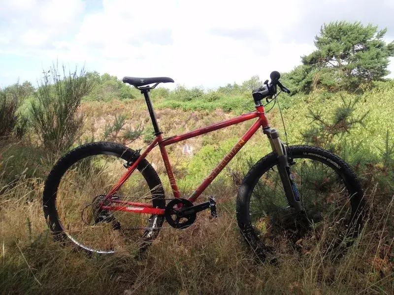

Hi, here is my new build for this summer! :)
Frame: Steelman Manzanita, Reynolds 853, 2001(?)
Fork: Fox F80 RL
Headset: Chris King Classic
Stem: Thomson
Handlebar: Ritchey WCS
Grips: Oury
Brakes: Avid SD7
Shifter: SRAM Attack
Rear Derailleur: 105
Cassette: 8spd 12-28
Crankset: Truvativ FireX
Chain: Sram
Pedals: DMR
Hub Skewers: Mavic
Wheelset: Mavic Crossmax '98
Tyres: Michelin
Saddle: Brooks B17
Seatpost: Thomson
Seatpost Binder: DKG
Check out Brent Steelman's site

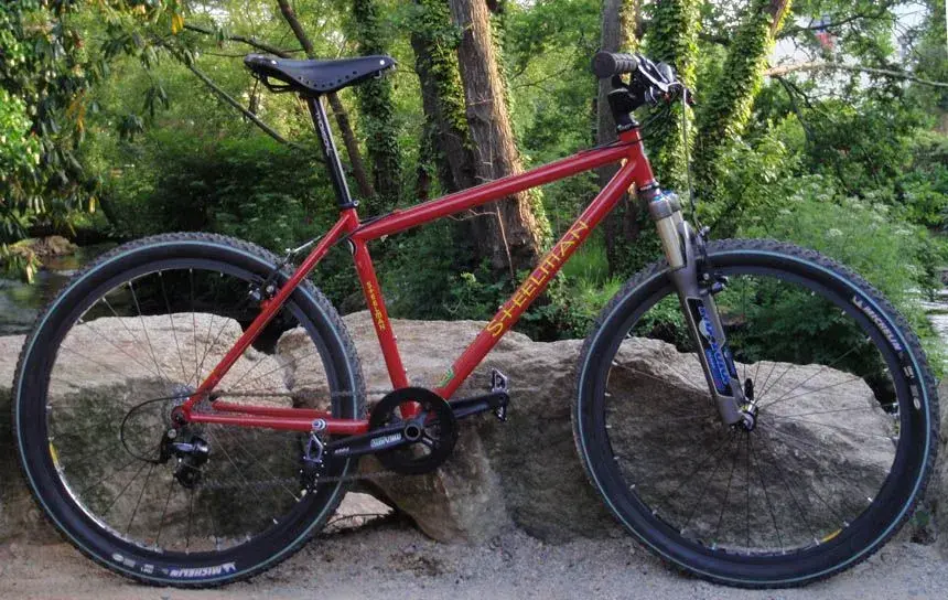

The seat tube angle looks quite steep - how does it handle? And do you have a chain -stopper to stop it dropping to the inside?
Took me bloody ages to drill that brooks, workshop smelt like a BBQ :lol:
PostPosted: Wed Jun 02, 2010 10:49 pm
Joined: Sun Oct 11, 2009 11:01 pm
Posts: 583
Location: France
thanks dave!
and thanks for the saddle, it's pretty darn comfortable...
chain hasn't dropped yet, and i've been on rather rough terrain.
the angles are not quite like they seem on the first photo...
here it is, corrected. it's classic angles, really (though i haven't measured yet). handling is exceptional! best cornering bike i own.

measured angles are 71°/74°
frame was built around a Marzocchi Z2 which if my infos are correct is 440mm a>c
the fox is slightly higher (450mm sagged)

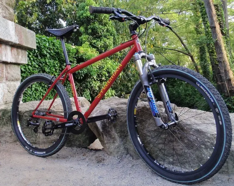

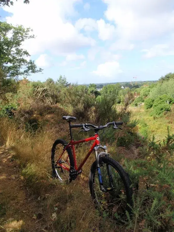

new version comes with different michelin tires and a modernish wtb saddle as i figured that the brooks didn't enjoy much being washed.
