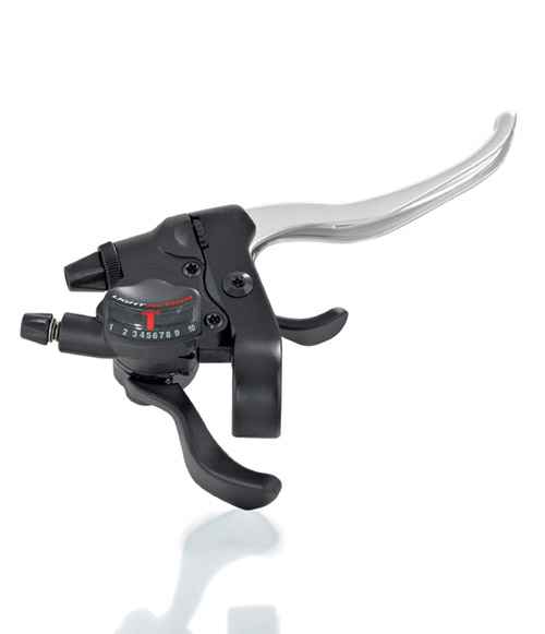

Just remember that the pull per click is different with 10s and 9s, and it all gets a lot more finicky in general. I wouldn't advise trying to get 10s shifters to work with 9s cassettes for example. You'll probably get it to work - sort of - and then it'll all go off with the first bit of mud.
Also remember that road front mechs need different cable pull compared to MTB ones. The CTC website has good info on how to mod an MTB front mech to work with road shifters.
Why not get some 10 speed flat bar shifters and run 10 at the back?

So, just to be clear I can put a 10-speed cassette on a MTB hub and run a 10 speed chain with no issues?
