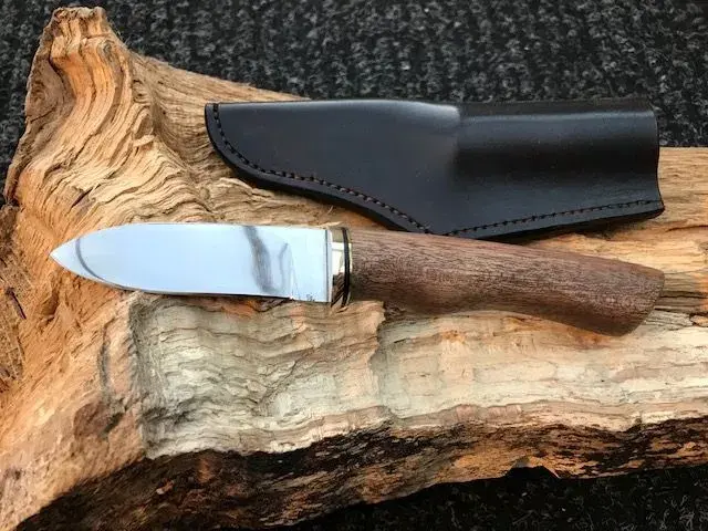

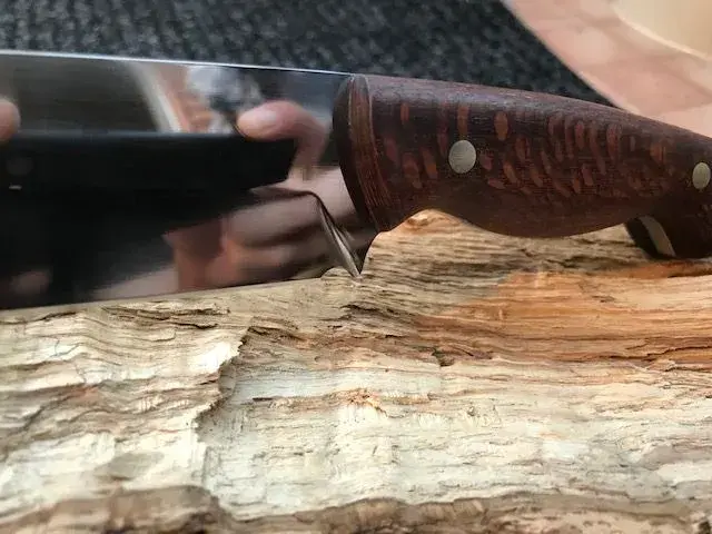

A couple of knives I've finished in the last few weeks. I've yet to make a sheath for the larger one. Both are forged from old steel I have lying around. All forged, heat treated, tempered and mainly hand filed with a little bit of machine work.
A little utility knife, 3" blade (was a coil spring from my old truck) brass guard, felt liner and Sapele handle.

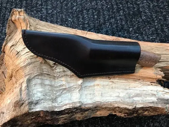

Something a bit bigger, 5.5" blade (Leaf spring from a different old truck) brass pins and Leopard wood scales.
