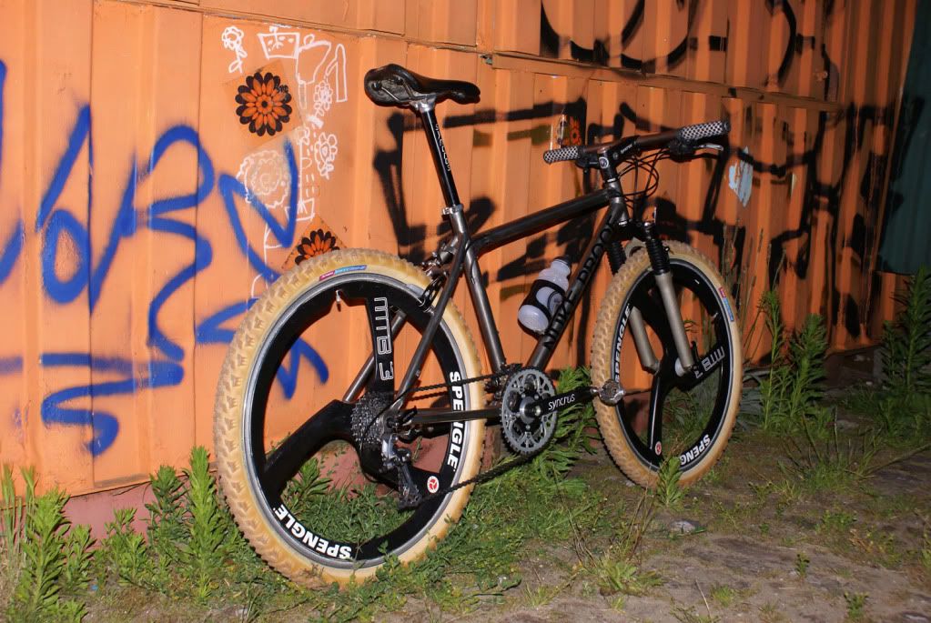

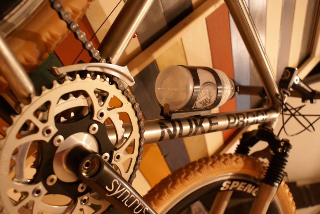

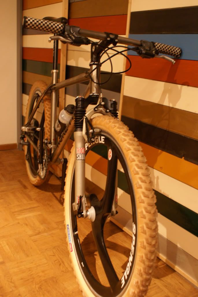

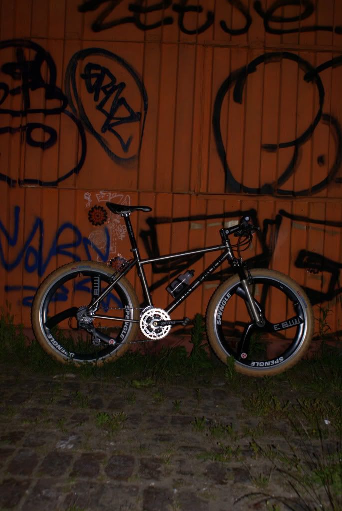

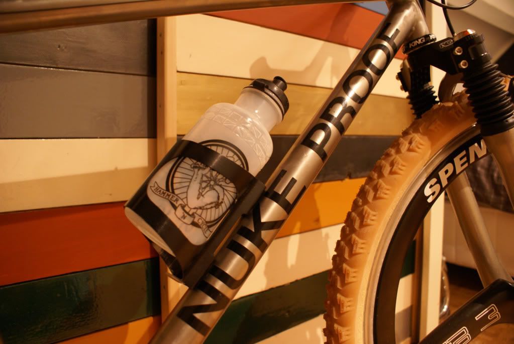

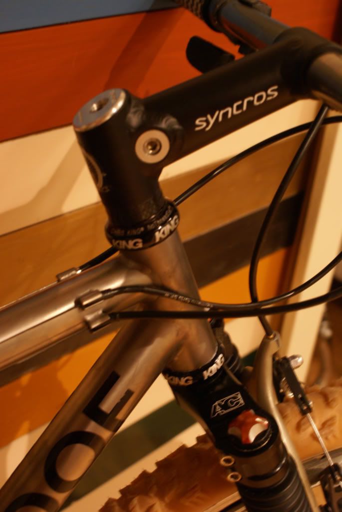

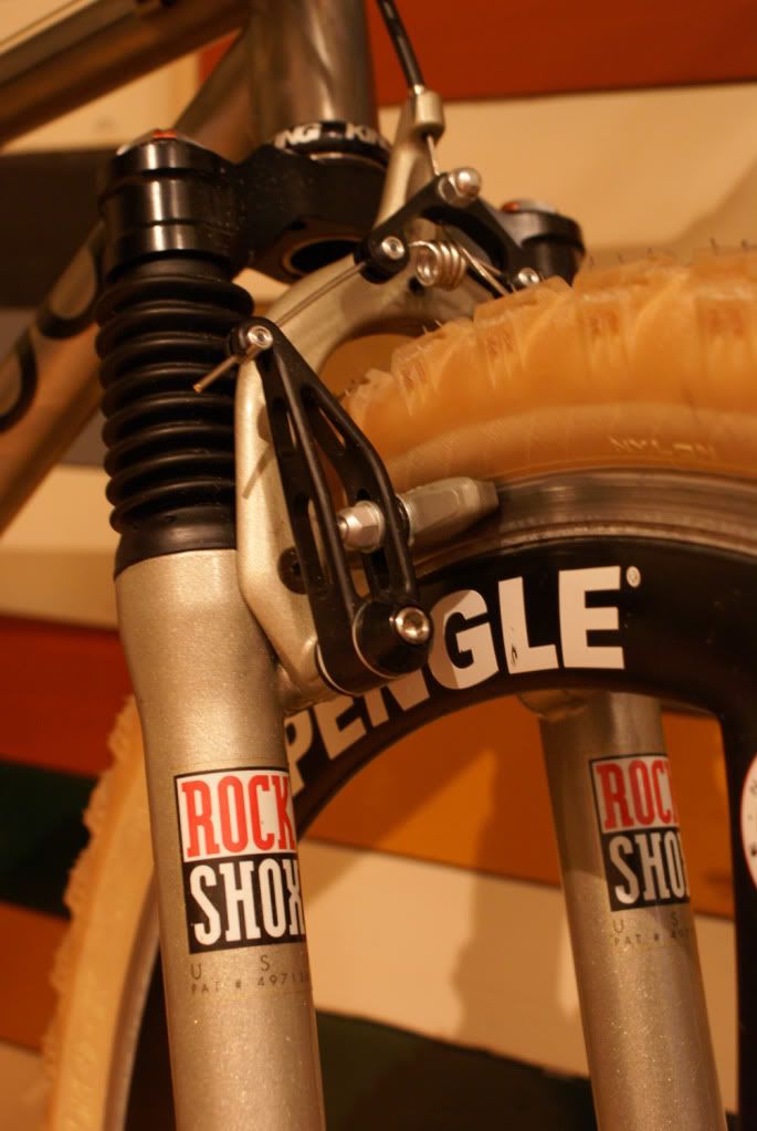

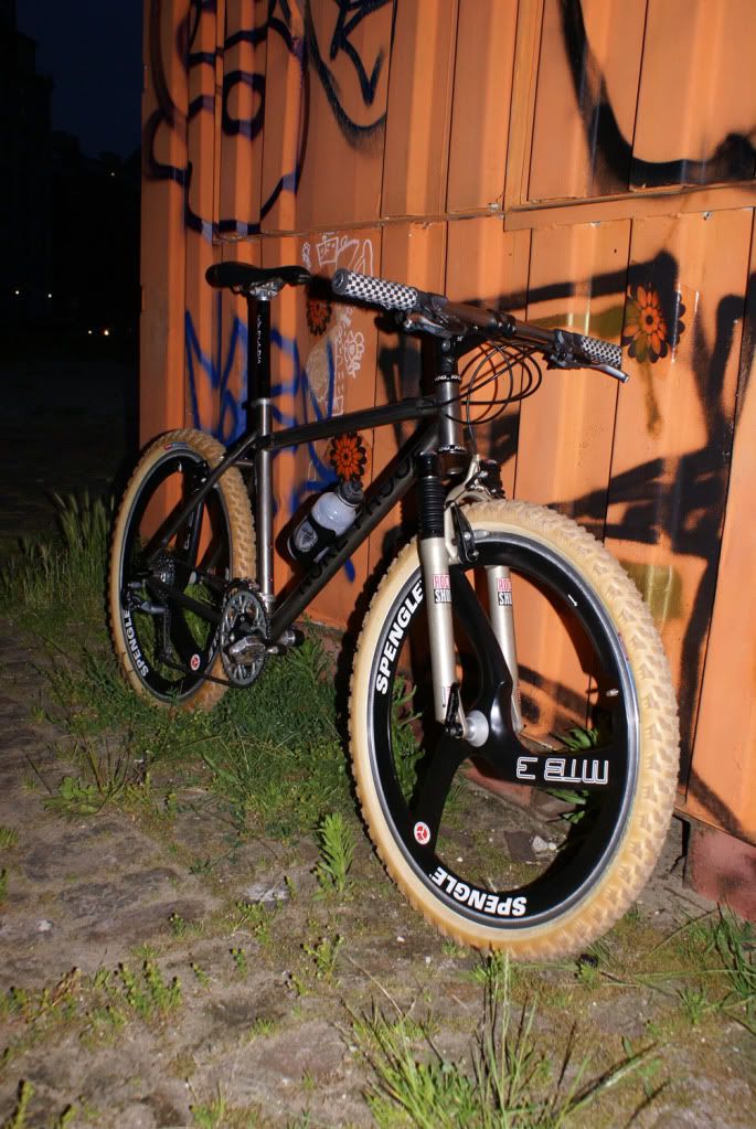

I build this one up for my Girlfriend:
drove this for the first time just now and it is a joy!
And a great looker
Wheels I do not like, will replace these (who wants them? ;) )
Frame: 1995 Nuke Proof Titanium 17"
Fork: RS Judy with AC crown
Headset: Chris King
Stem: Syncros Ahead
Handlebar: XLite Titanium
Grips: Some old school style
Barends: none
Brakes: Control Tech (NOS)
Brake Pads: Kool stop
Brake Levers/Shifters: Shimano M950 XTR
Front Derailleur: Shimano XT
Rear Derailleur: Shimano XTR
Cables: Shimano XTR
Cassette: Shimano XT
Chain: Shimano HG
Cranks: Syncros Revolutions (temp)
Crank pully: Syncros Crank-0-matic
Chainrings: syncros and something else
Bottom Bracket: Shimano XT
Pedals: Onza Ho titanium
Hub Skewers: Syncros
Rims: Spengles for now
Hubs: Spengle
Spokes: Spengle
Tyres: Tioga Spycho II Amber (NOS)
Saddle: Flight titanium
Seatpost: Syncros
Seatpost Binder: Nuke Proof
Bottle Case: Ringle H2O
Bottle: Syncros (now)
Quote:
NUKE PROOF Ti Race ATB Frame
Nuke Proof builds each frame 100% in house, from the tooling design, to mitering the titanium, to laying the beads. The frame has oversized tubes and a sloping top tube to increase bottom bracket stiffness. The seat stays and top tube are situated offset to each other which alleviates a "whippy" feel in the rear triangle often found in other titanium frames. Each frame, weighing just 3.3 lbs., is designed with suspension-ready geometry. The attention to detail and time dedicated to each frame results in perfection! Bottom bracket height: 11.5", Chainstay length: 16.75", Seatpost: 27.0 mm, Headset 1 1/8", Top pull derailleur: 1.25", Titanium (frames): 3AL/2.5V, Titanium (dropouts): 6AL/4V, Frame size 20", Center to Center 18", Top Tube 23.5", Angles Head/Seat 71/73, Head Tube 5" (127mm).

Damn nice Bas!
Again!

syncros cranks.....you must really love her.

Lovely, glad to hear the wheels are going!

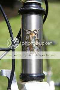

The bike is lovely.....did the Ti bikes not have the Cockroach on the headtube?
The wheels.....Hmmmm...I'm pleased you are swapping them :wink:

yes you are right but on this one there isn't, unfortunately,..

lovely!
(apart from those wheels and tires!)
