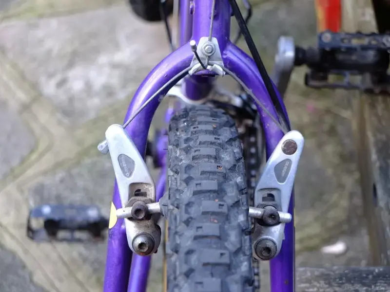

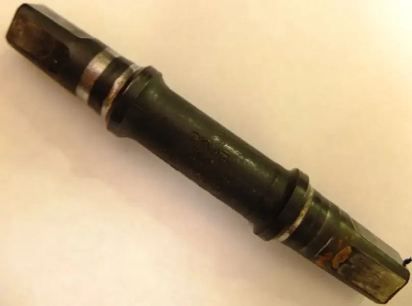

There are a few small bits I might change. The bottom bracket is currently loose... if it turns out to be worn/damaged I might pop in a new sealed unit for future low maintenance. The wheel QRs are later replacements in black alloy. And I'm not sure about the straddle wires/hangers which are Weinman ones which doesn't seem like an obvious choice. I fancy using link wires for a change as Shimano intended. Anyone know what Orange used?

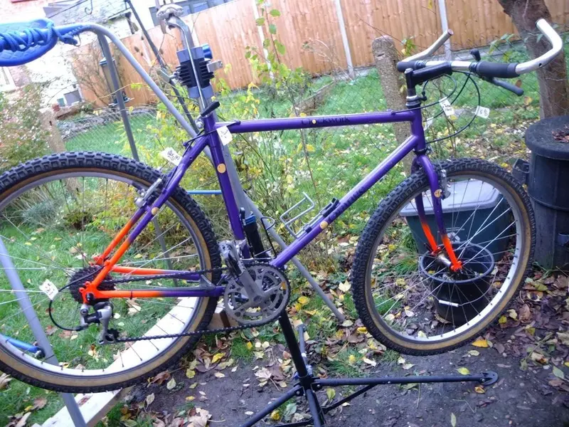

Had a good morning. Got the frame completely stripped. Had the bright idea to label the cables. Learned that the headset is almost as notchy as the thumbies. Haven't checked it out yet but it might benefit from replacement.

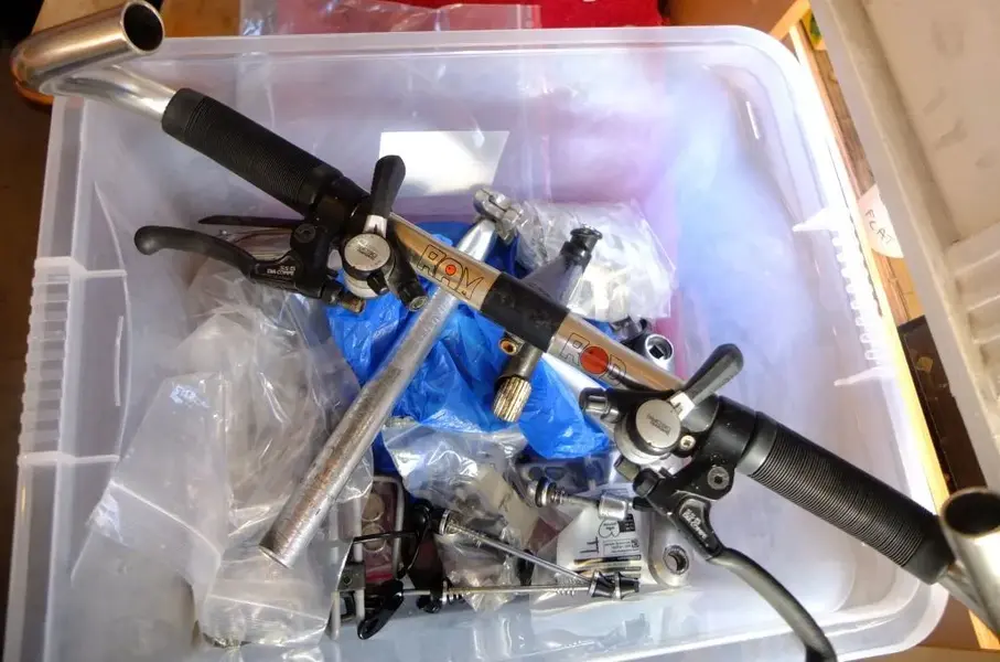

Filled up a box with bits of bike. In two minds re stripping the bars down - want to preserve the grips and slightly nervous about scratching them when I remove everything. Something to do with care, anyway.

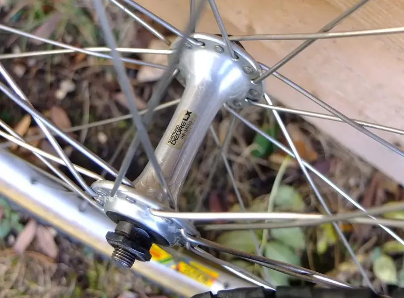

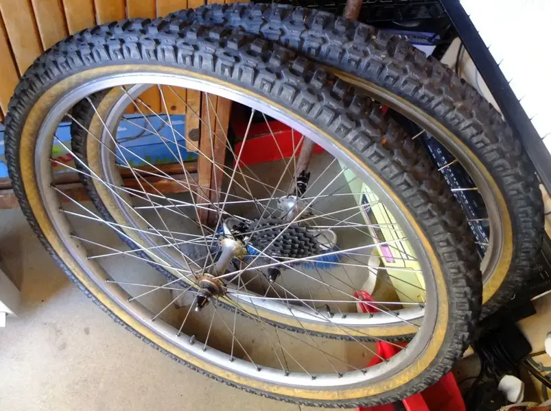

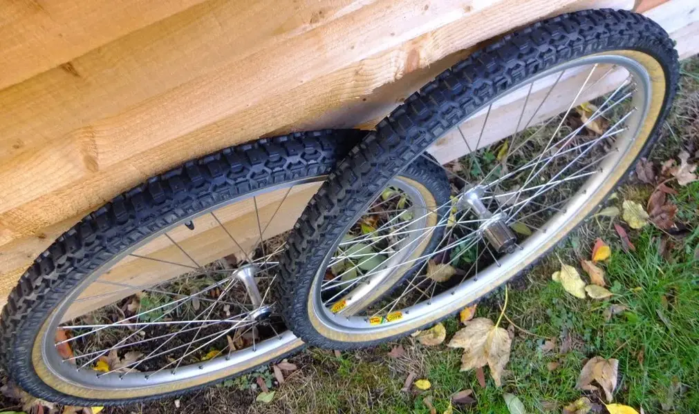

Cleaned up the wheels & tyres. Need a true and hubs greasing. Thinking I might replace the original tyres with a pair of Smokes for the sake of having some fresh rubber under me.

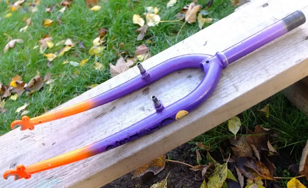

And gave the frame and forks a good wash:

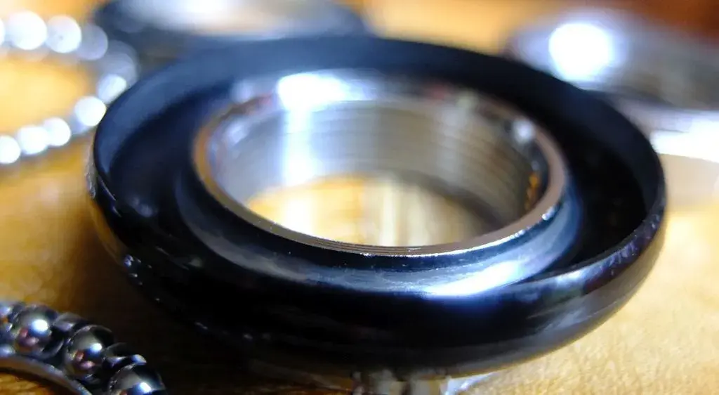

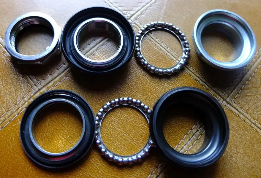

The headset came up really nicely after a good soak in white spirit and initially I couldn't work out why it felt notchy. On close inspection the top cup has some (fairly mild) brinelling as I've tried to photograph. The other cups look like new. I'm wondering if new loose balls will make enough of a difference or whether to bite the bullet and replace it.

Bottom bracket is worn. Could probably get away with using it but I've got a practically brand new BB-UN55 in the right size so I think I'll use that instead. Not a great pic, but here you go.

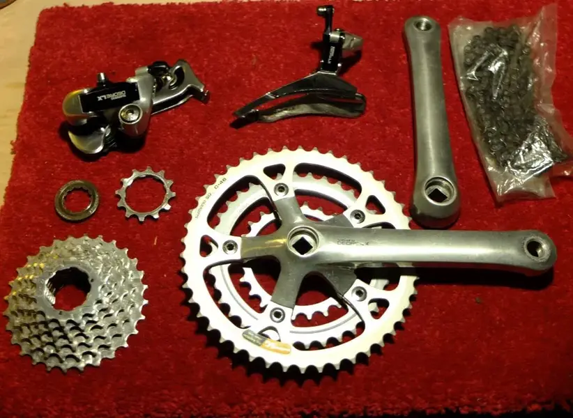

Have cleaned up all the drivetrain components and a few extra bits and bobs. There is some wear to the chainrings and minor damage to the rear mech but a good few miles left in all of it I'd say. Having ridden it first is reassuring at this stage and probably saving me money in terms of replacing stuff "to be safe". I did order a set of smokes off of Jon Smith. So that's pushed the budget up a little... but worth it, hopefully... plan to ride this lots...
Anyway, lots of shiny bits ready to go back on. Nice feeling.

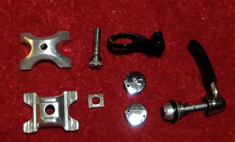

Will have to see if I can find a better o-ring to go on that seatpost QR...
