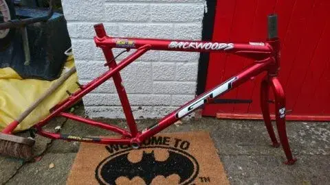

Trying to find a suitable frame has taken some time, and I'm not quite there but close enough to start, so here goes.
One red ano GT Backwoods ready for a very non standard build.
I'll try to dig out some snaps of the old beast to upload for a guide :D
I'm resigned to not getting it 100% as some of the parts were cheap and just are not found these days, but I intend to get close!

Got a few minutes yesterday so managed to get the frame cleaned down a bit and take a closer look. There are a few marks so it's certainly not shop fresh this one but in fairness to its 21 years it's not all that bad.
The parts are coming together nicely, I'll get some snaps up shortly
