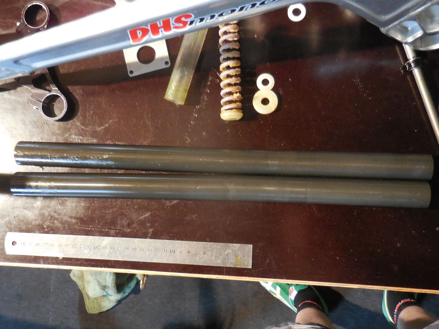

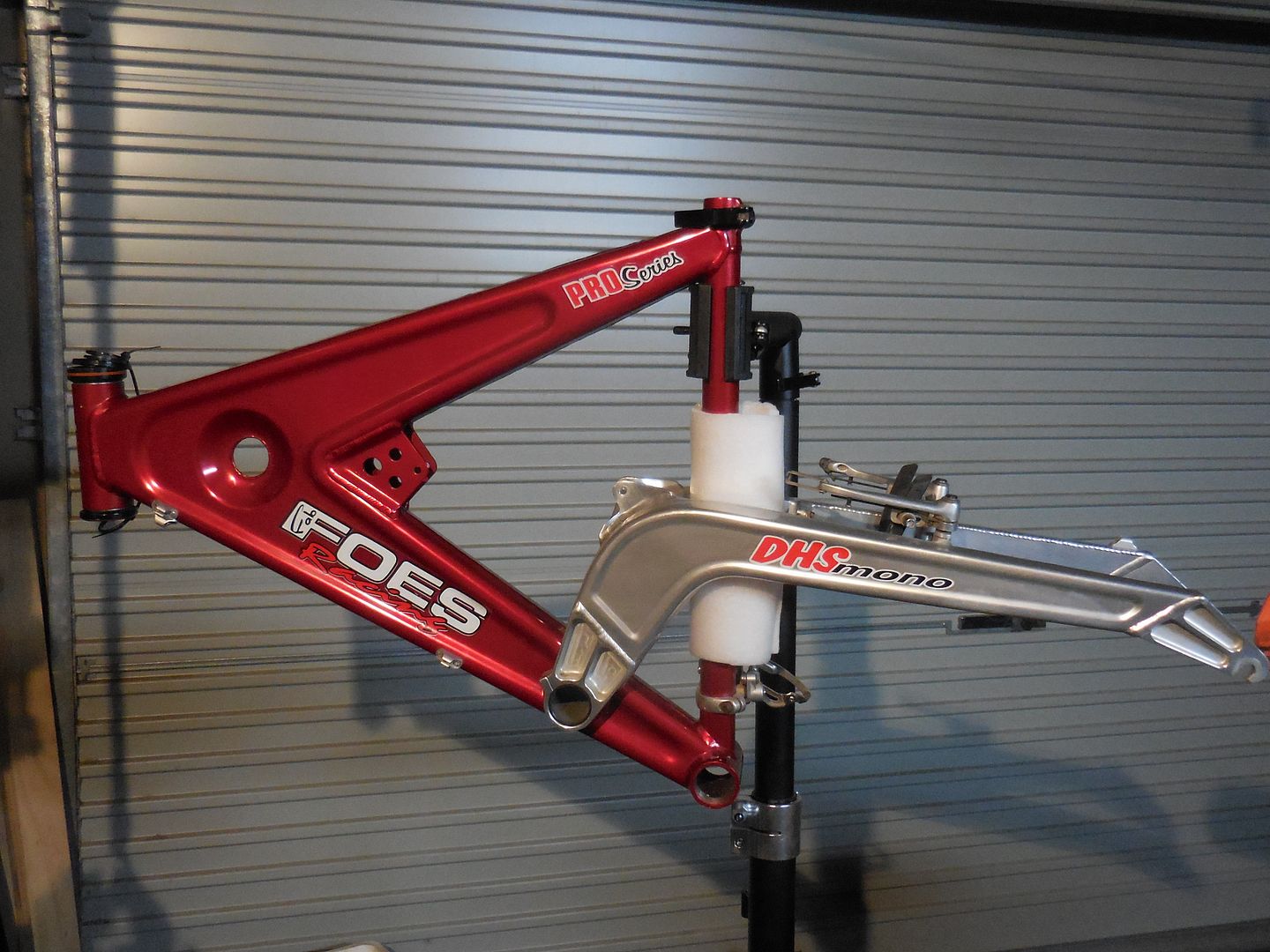

So I soon had a closer look at the goods.
Unfortunately, the seller had been pulling my leg quite a bit!
The swingarm has previously cracked, been welded and cracked again. Dam!

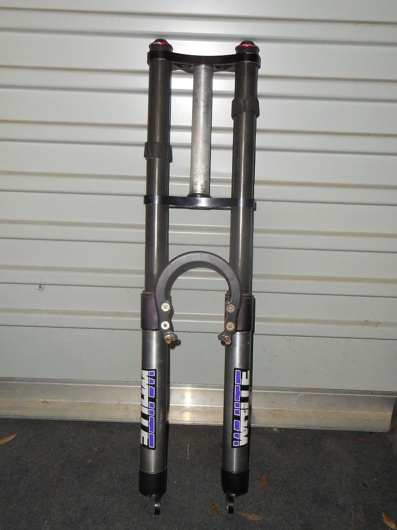

I turned my attention to the forks. They are stuffed too.
What is wrong with these people?!
Jeffro

Am chasing some frame repairers for some major intervention and have been able to locate some new fork stanchions.

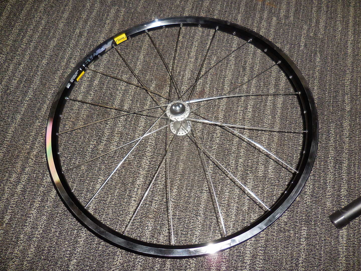

Time to build some wheels. I had a set of Mavic D521 wheels which I built back in the 90's. I still had them up until a few months ago when that bike got stolen, prompting the desire to build a new bike.
I could not track any D521's down, so elected to go for the modern equivalent, XT no-disc hubs and DT straight gauge 2mm spokes.
Jeffro

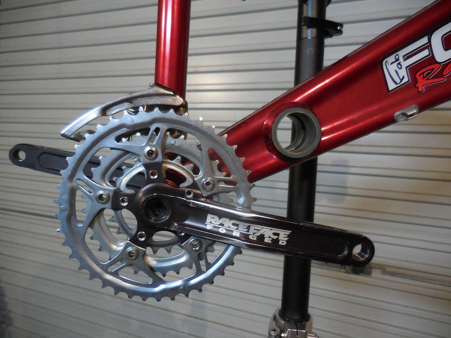

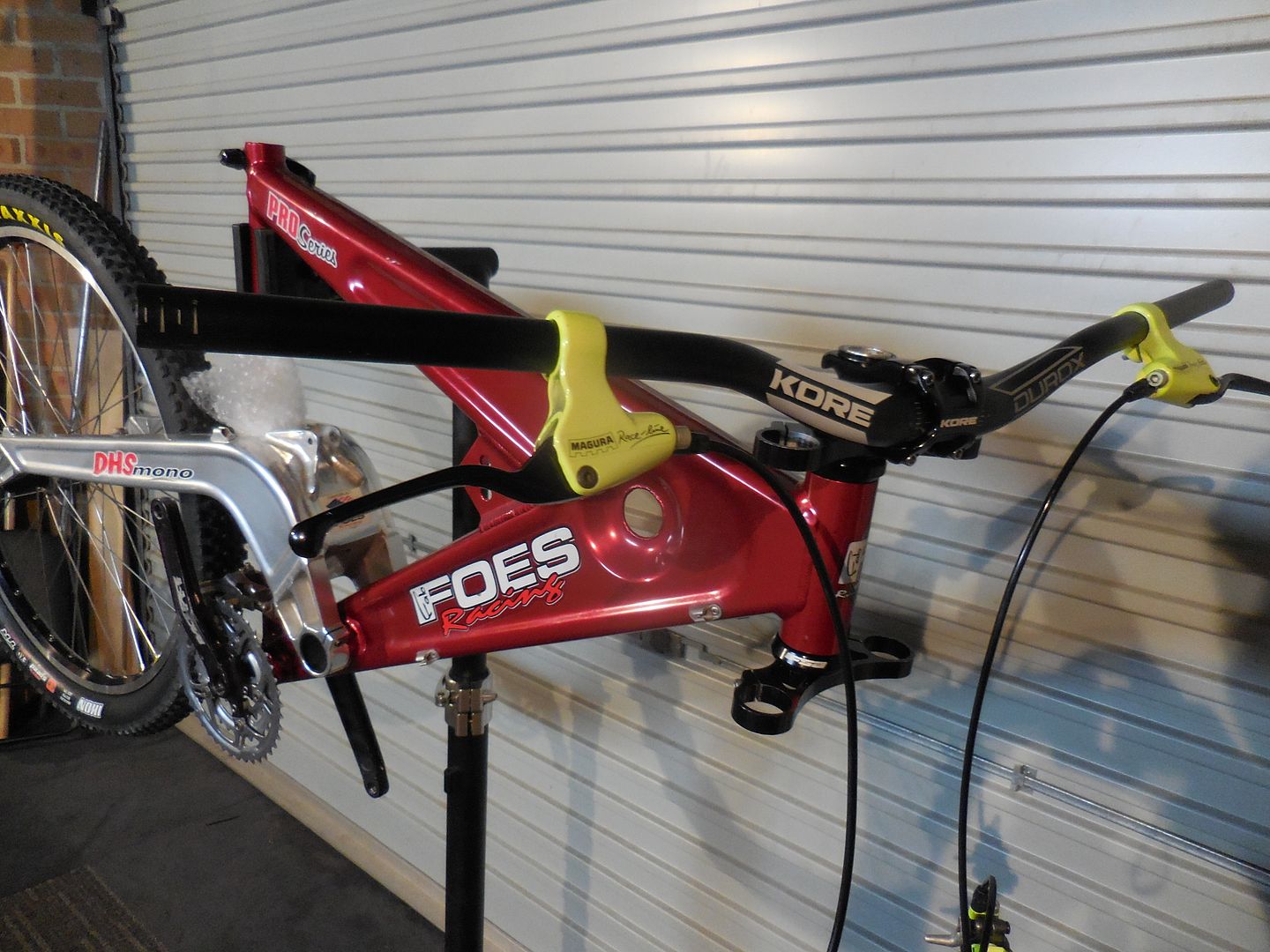

Tyres on.

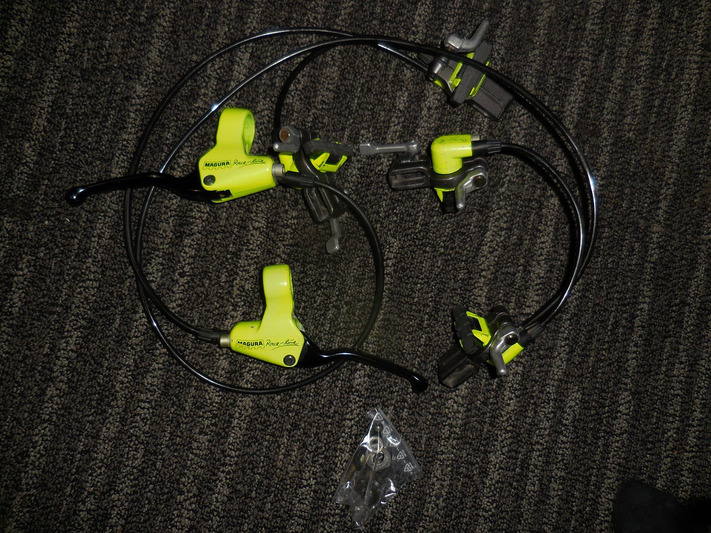

Brakes turned up. There was only one choice.

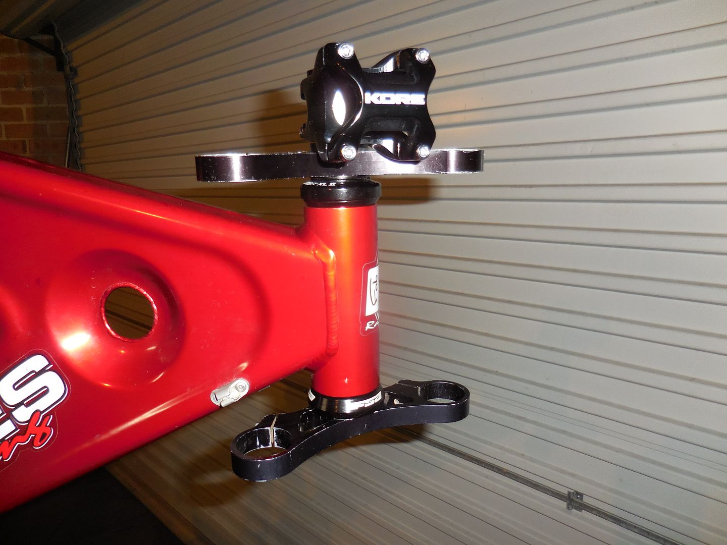

I ran into an issue fitting the new headset. Frame is 37mm ID or 1 1/4 headset. After some investigation and weighing up options, I have elected to use a spacer for now rather than the CK Devolution option.
Yes it is coming along nicely......
Jeffro

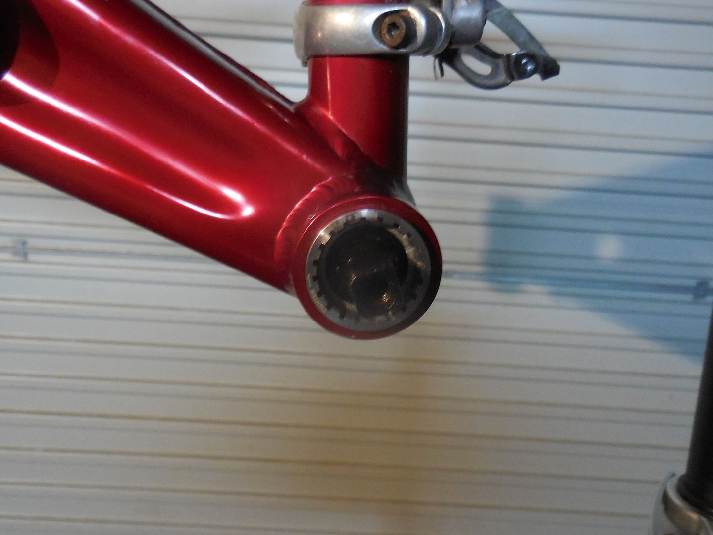

I had some trouble getting details on this bike. Here are some measurements FYI
Frame Dimensions 6061 T6
Seat Tube 19.5"
Top Tube 23"
Seat post 27.0
BB 68mm
Rear hub 135mm
Steering tube 113mm
Seat post outer 32mm
Rear shock mount spacing 22mm
Front shock mount spacing 23mm
Shock holes 6mm
Steerer ID 1 1/4 37mm
Shock Length 180-190mm
Shock Stroke 51mm

I really like the frame, will get the swingarm repaired with an almighty gussett and keep an eye out for a replacement swingarm. A little research reveals this location to be common to fail, so not sure about my chances of finding one not cracked, but I have a design in mnd which will increase the strength significantly without impacting on the original styling.
