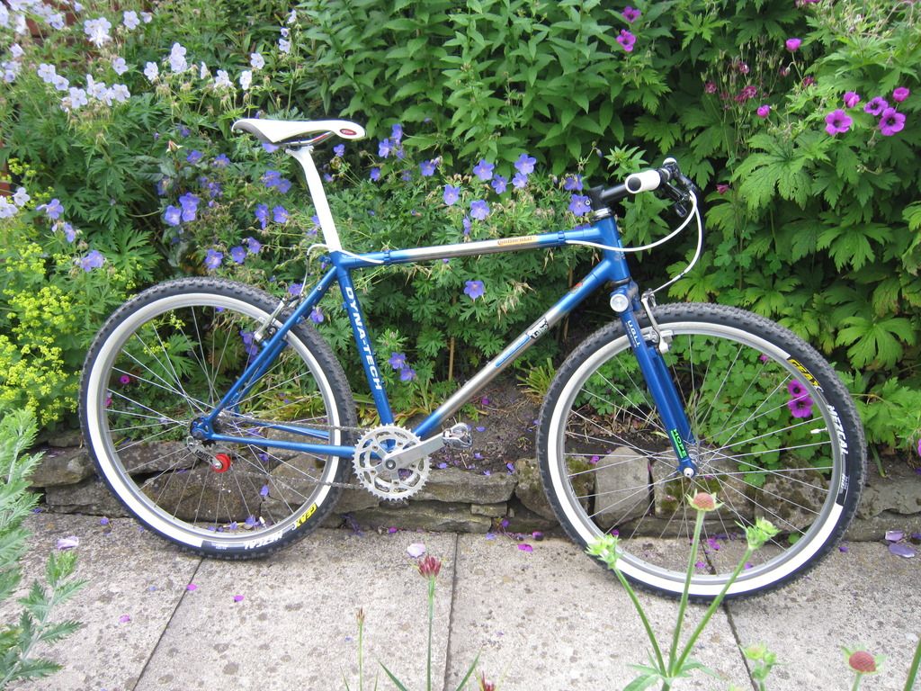

Checked over my old bonded frame that was hanging in the garage and decided it was good
Found some wheels and started the build . . .
original Ti bars are there but Ti stem was repainted black (got old MTrax one on for now). Reckon white grips would be nice
need to find a BB and crank set in my boxes, then have to figure getting the chainline/cogs sorted
Re: 97 Dynatech Diablo rebuild as Single Speed
Today I swopped back to original Ti HB stem and tracked down the BB, cranks and pedals. Reckon the stem will have to go back to bare Ti though
Boring old Shimano 52 BB in for now. Pedals are old "grenade" style Shimano SPDs from mid 90s, but one bearing feels goosed so might look for something else here
Crankset is an old White Industry triple ring I swopped off for XT in late 1990s - after a few teeth breakages, chain rings look minty
Have pulled off the granny ring of cranks but hoping to run without a chain tensioner so leaving 32 and 42 rings on for now
Over the w/e hope to put a cassette wheel in the back and figure a good cog size / chain line - looks like I binned my old cassettes at some point (which I was planning on stripping for spacers) so may have to pay real money for a spacer set

finished the singlespeed build and it is great to ride, but yeah seatpost isnt quite right yet. Ended up swopping the all white tyres for white walls though - bit more subtle :cool:
once the seat is fixed will post another pic
Most of the parts were in the garage but had to get some white grips and brake casing from On-one. And black Deore levers from Chain Reaction. Gearing is currently 32 x 18 - lots of slack with 47 link chain (and DMR tensioner), 46 link nearly worked but was too tight. In time I might go to 34 x 19 as my calculations and measurments suggest that will work without tensioner

thanks kyle888 - I think your own bike is a bit like your own kids, very special to you but not to others. I am good with that. This Dynatech was a wonderful companion on some great rides, with some great friends. It was built because I love that bike and wanted it to live again. Also going singlespeed was cheap and levelled the playing field when out riding with my kids
Here is the finished article, as close to original as I can get from the bits I already have. - including original Ti Stem and handlebars. The stem was painted black for an MTrax all black stealth build, so plan to strip back to bare Ti come the winter. Went for V brakes over the original STX SE cantis, partly as I might yet sell them as they are minty
Wheels are original STX SE Hub, DB spoke with Bontrager/Weinmann rims, bitza skewers. White Industry /Sugino chainset running 32 / 42 and 18T rear (courtesy of iveto1983/Pat on retrobike - thanks Pat!). Once I get a feel for the best ratio hope to lose some chain slack, 34 x 19 is looking like a good option as it might work without tensioner, but means more expense
Picked up a cheap white seatpost from PlanetX - not as subtle as a plain alloy but £15 and 240gm. Tyres are white wall Mezcal and sooo fast
Biggest expense was the Flite Ti saddle - but that doesnt count as it was a birthday present (and only £30!)
Absolute blast to ride - totally get the single speed thing now :cool:
