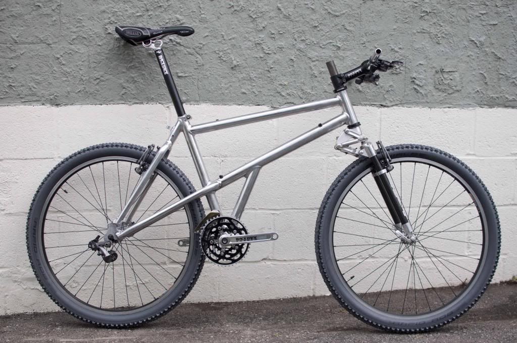

Here's mine... I started wanting to use the original tange fork... but I wanted to go threadless... so I had the steer lengthened... But... then I decided to swap to an amp fork... this is how it sits now... still unfinished :LOL:
Now... IF you want that original fork with extended steer I'm happy to sell / swap it with you... I can measure the steer but this is an 18.5" frame so as you can see lots of extra steer there for your frame so it will be just fine... (But since it was extended you would have to go threadless...)

Thanks! I think I will go for a threaded fork on this one, to keep it close to original. The AMP really looks good on this frame I have to admit, which is a bit of a dilemma as I think the Experience was really made for rigid forks with it's trial geometry. Maybe a set of Powerlites would suit.
I measured the headtube, it is 153mm. Adding a 37 mm stack for a headset means I need to source a fork with a 190 mm steerer....

I wouldn't let the fork tube lenght stand in the way of your fork choice, if it is to short just lenghten it.
troje":2blcrqqr said:
Thanks! Do you happen to know any specialists in Holland who can do that?
Remember.... When you lengthen a steer you can only use it as a threadless setup...
This is because an insert has to be added on the inside of the steer behind the but join. If the join is right close to the crown and your head tube is very long then there is a SLIM chance that there will be enough space above the insert to allow room for the quill to reach down into the steer. I have had many steers lengthened and have not been able to accomplish this yet
