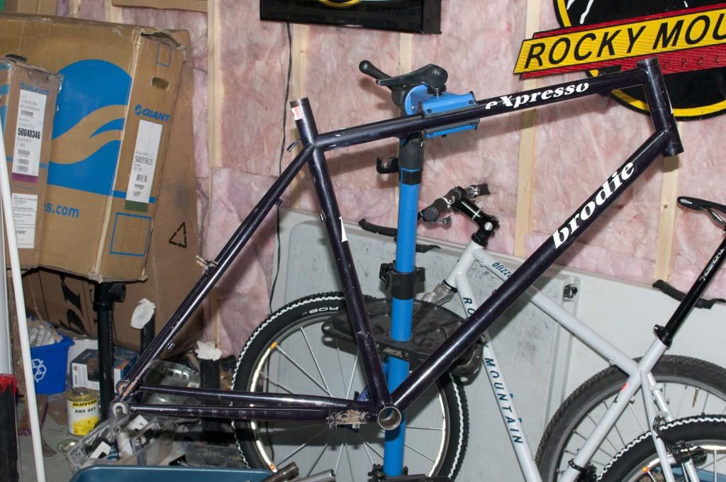

So... here it is... this one needs some work...
Someone apparently doesn't like cantilever brakes... and also isn't very handy :facepalm:
First step is to remove that cable stop :D
This frame is suspension corrected for a Judy XC but it will be getting a Mag 21... Why? why not 8)
More pics to come... I added in a pic of the blue parts that will be going on it..
Oh... and the frame will be painted Orange 8)

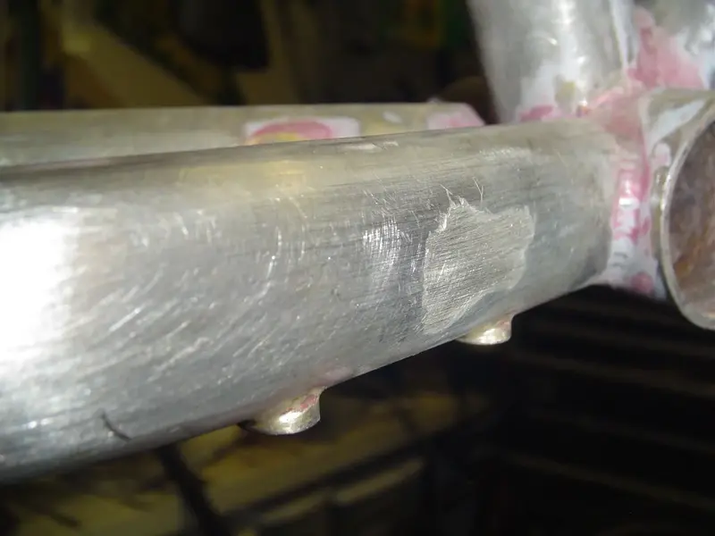

Very nice Shutter,,at least PO didn't hacksaw off the cable guide,,stop is probably silver soldered on ? should fall off with a propane torch..
I have a Expresso project also,starting today if I have some time...
 Post subject: Re: Re:
PostPosted: Wed Nov 12, 2014 11:38 pm
Joined: Tue Mar 05, 2013 2:00 am
Posts: 2007
Location: Toronto, Canada
Thx!
Well... Yes, but whether I cut it off or hear it up I'm still going to have to file off the excess brass left behind. I would rather not hear it up any more than it already has been and just cut then file.
But tell me if I'm missing something here??
 Post subject: Re:
PostPosted: Thu Nov 13, 2014 2:04 am
Old School Hero
Joined: Tue Aug 26, 2014 4:25 pm
Posts: 166
clean off the paint and see what colour the "weld" is,,if it is brass,then it was fillet brazed on,better to cut it off..If it is silver,,then silver soldered on,heat it up with a propane torch and it should fall off,,solder melts at a pretty low heat,wont hurt the frame.It's made to melt before the copper and brass it's used on.
I have used solder to fix chain suck on a frame a few times..
But please,,if you are uncomfortable at all,,please find a friendly neighbourhood frame builder,,I don't want anyone mad at me.!.
True, if it is solder even a lighter or match will melt it off =) I will investigate

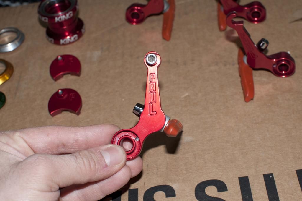

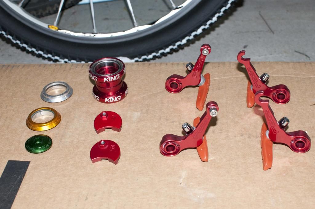

So... it begins...
Is this over the top?? Orange frame with a mix of blue and red parts??
Headset is a mix-match from my parts bin
I Could stick with JUST blue components... get a blue CK headset, and maybe silver brakes??
let me know... =)
