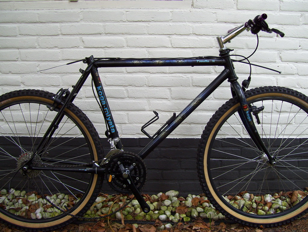

This Sunday I purchased a 1991 Koga-Miyata TerraRunner mountainbike. I travelled 150km per train and rode the bike back home. It performed flawlessly. I've climbed the Van Brienenoordbrug and I went through the Kralingsebos in Rotterdam. The Kralingsebos was very crowded with families on the beautifull autumn day. People queuing in front of the 'patatkraam' and the 'pannekoekenhuis' faced possibly the best day of the year. No trace of economic downturn could be seen.
Miyata used their own oversized Hardtlite FM-1 Spiral Spline tubing for this frame. The oversized dimension of the tubing was new for 1991. Other modifications to the frame compared to the 1990 TerraRunner included:
- toptube cable routing
- 1-1/8" headtube
- 29.6mm seatpost (was 26.8mm)
- new geometry
Interesting is the generous number of braze ons: there is a fitting for a race number(!), but the frame is also ready for heavy duty trekking (fittings for rack, low rider, 3 cages etc). The frame is finished in gloss black with a blue-gold graffiti spray. Similar could be seen on Koga FullPro and Miyata 916 of the same era.
The bike is undergoing an overhaul atm. The bike was acquired in full original spec and with hardly a sign of use. Koga selected only quality parts for this TerraRunner, but I decided to put focus a bit more on weight saving. The diet will consist of parts like Onza Chill Pills, USE handlebars and Ringle Ti-Stix skewers. NOS parts, so conditionwise in line with the rest of the bike.
The paintscheme is the same as on the 1991 Koga FullPro and 1992 Miyata 916.

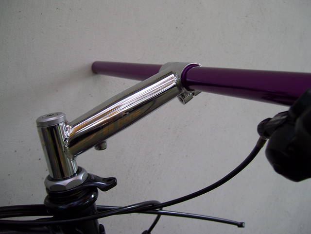

Tioga T-bone Prestige stem holding USE bars >>>

Ah yes, this one stuck around on marktplaats for weeks as "reserved" - very frustrating! Looks like it's in amazing condition, even had the original pump & bidon if I recall. Love the details on the paint job.
I ended up getting a '90 terra runner for my trekking plans (see this thread), but the lowrider mounts, OS tubing, & top-pull front derailleur on the 91 model make it even better suited. Maybe the best mtb ever for a touring conversion.

That's the one! Yes, with original Koga-Silca pump and two Cobra bottles. The 2nd cage/bottle sat fitted under the downtube. Yes, pretty amazing condition. I think the bike covered more km's on Sunday than in the 21 years before :roll:
The 1990 TerraRunner is very nice too. The 1991 model is possibly the ultimate frame for heavy duty touring. The frames of the 91-93MY ForeRunner/ValleyRunner share the same features!
