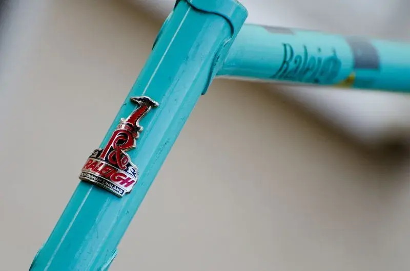

Anyways, after saying this would be a slow burner the lure of sunshine and the garden last night meant that I got stuck into cleaning up the frame and associated bits after work. The frame is actually quite good - there are plenty of scratches but only a few chips. So I broke out the 2000grit paper and the G3 cutting compound to try and renovate the paintwork. The images show the front end cleaned up - the rear triangle is yet to be attacked.

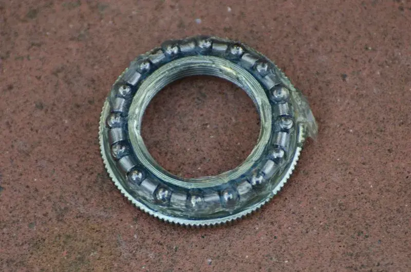

I also washed the old grease out of the headset (using petrol!) and re-greased to reassemble the forks. Never seen a headset like it.....

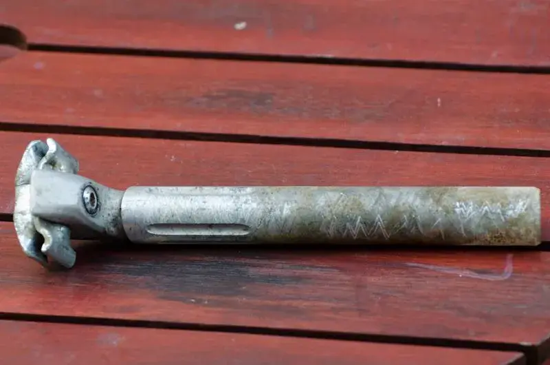

Seatpost has had a cleanup and a sanding to remove the oxidisation and marking....I'll revisit this to see if I can remove (or at least lessen) the zig-zig scratches, possibly with the help of my boss' lathe. Loving the fluted features on the back of the post - why is this done? Styling?
Headset bearings/cups are in really good condition - like new, so a degrease/regrease and reassemble was all that was needed to get the forks back on.....
