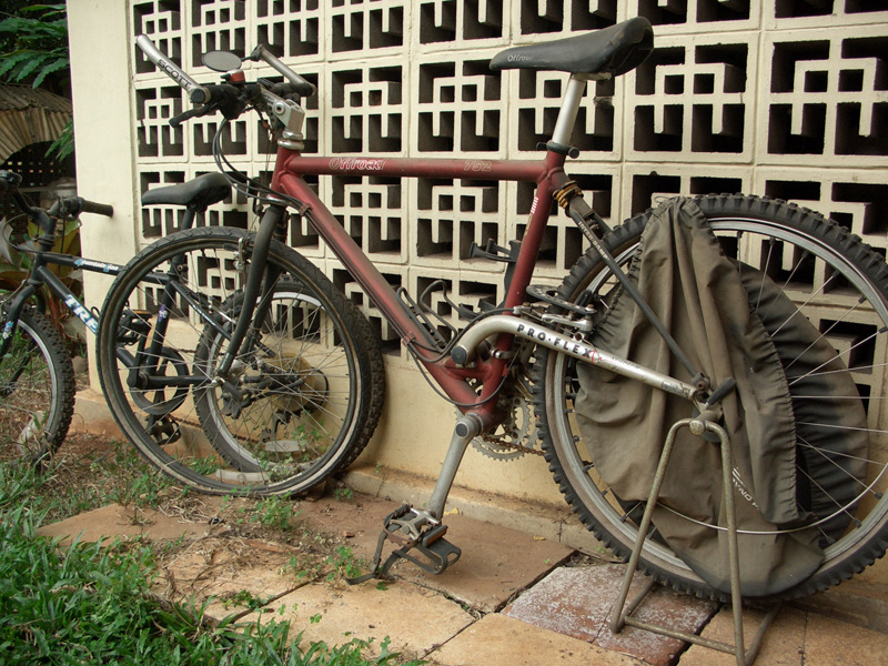

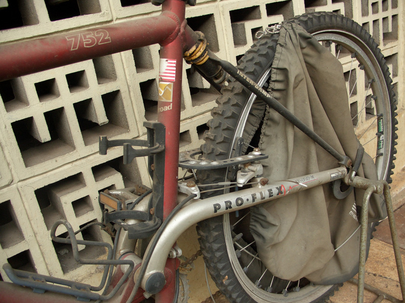

i really wish i could restore this bike to its original condition. as you can see, the elastomer shock is broken, don't know how to get the replacement.. :(

i have some elastomers to replace yours , but it looks like the yellow rings are smashed ?

yup, the yellow rings are smashed.. :(
about your elastomers, how much does it cost? is it included with the rings?

no rings , just the elastomers
but if you have 2 good rings , it should still work ?

If you need photos/dimensions of rings to replace them or have them made up, let me know as I have a 753 with the same setup.

SLIM, i think i don't even have 2 good rings. all broken..

to be honest a couple of suitable washers would do the trick - your local hardware store probably has them.

they are different dimensions though! Outside diameter I think from memory is the same but internal diameter is different.

Well... machining washers of any type is no problem for anyone lucky enough to own a lathe. For the bumpers, I had good results with top out urethane bumpers for motocross shocks.
