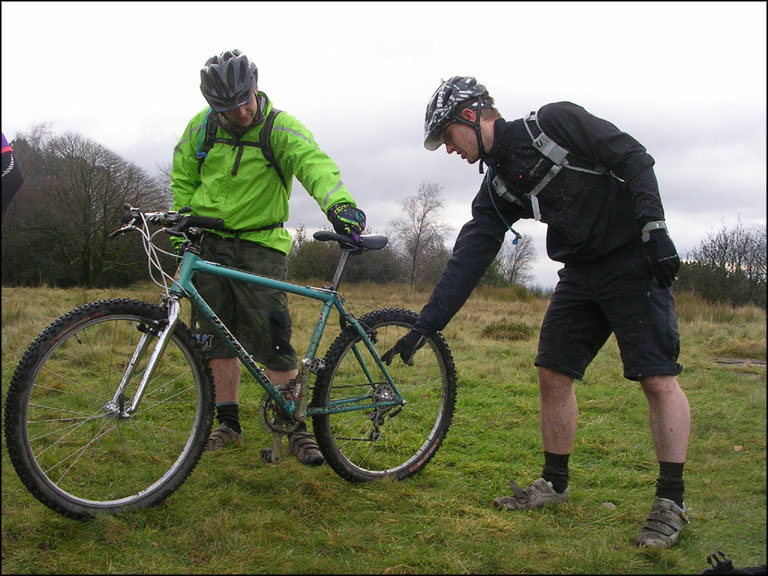

Another one to add to this thread Martin.
Lovely bike; as ridden about a month ago.
NWA Rivington ride - November 2010
