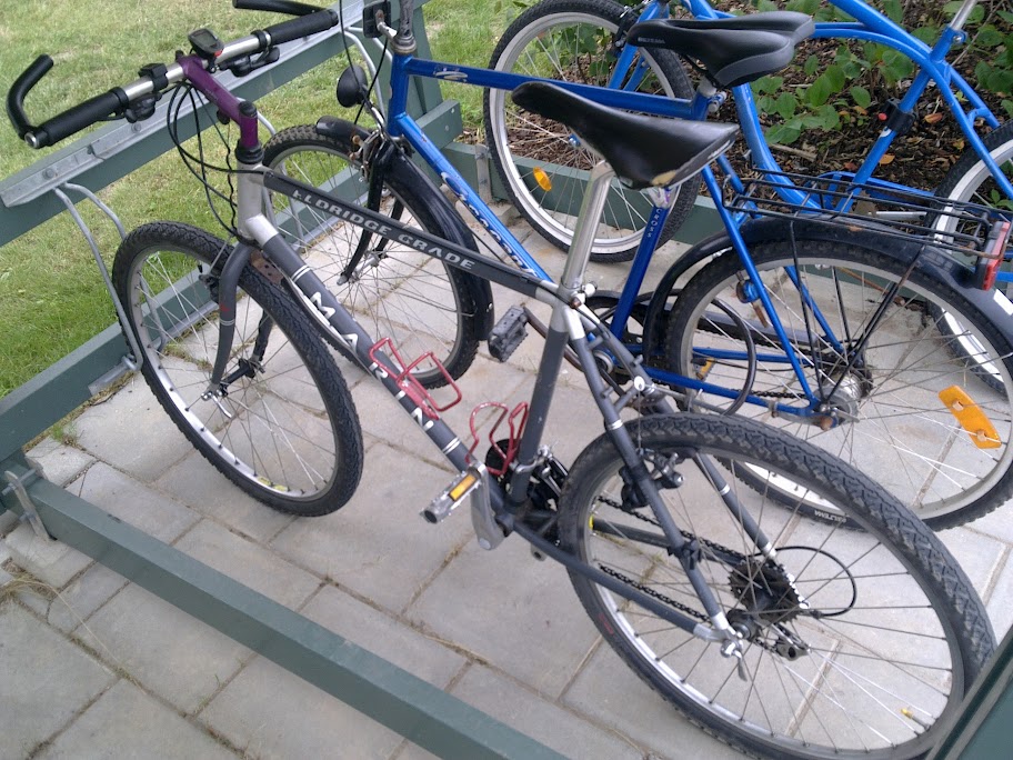

Just bought this one for 800 SEK (About 50£).
This one was a wet dream for me when I was around 10 years old, but I never got one.
I have seen many nice Marin projects here so I hope that this is the right forum to get help from.
What I want to do whit this one in the future is to unmount everything, repaint it and get some new stickers and the put everything together again, but with upgraded mechanics. Is it possible that you can help me in the right direction of what I should have? Gears / V-brakes et.c.
Or maybe it's better trying to refurnish the things I have?
But for now I only want to ride it a couple of weeks (I have not owned a bicycle for overs ten years. This is fun! :) )

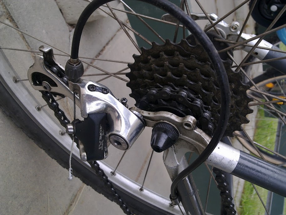

It needs some service (brakes et.c.), but I also have a bigger issue. The rear-gear does not seem to work so good when i push or pull the gearknob nothing happens... then all of a sudden it changes gear and then back again and stays on the second smallest gear.
Anyone knows what this could be? If it's a quickiefix I can try to do it now, otherwise it just has to wait until I will mount the whole bike down.
Must say that I have got plenty of inspiration while looking at this site!
My idea from the beginning was to just buy and use one, but now I want it shiny and nice, like yours.
Well. The problem with the gears is fixed. Opened the gear shifter and took a look. everything was a big thick grease. Cleaned everything up with degreaser and then oiled it with som lubricant i normally use for my flyfishing reels. Works like a charm now.
There is a litte spring that pull back a tap that select each gear. This spring and tap was not working at all. It has stuck in all the grease.

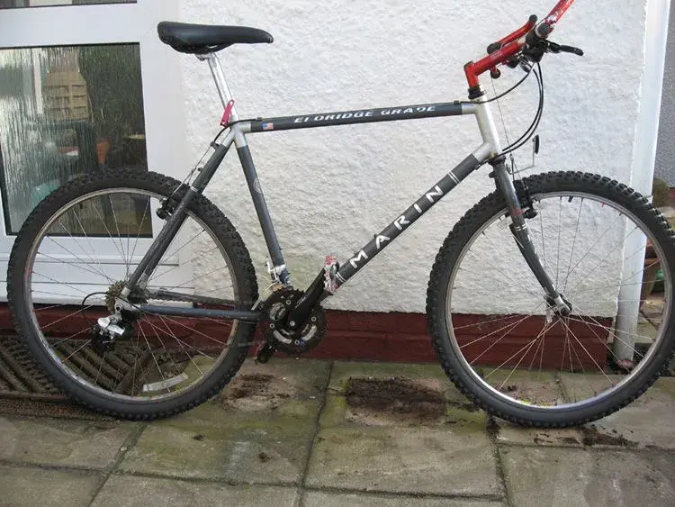

Welcome keckepro. I bought the same bike as you 6 months ago (picture below) with the intention of completely rebuilding/painting it but I've also enjoyed riding it so much that I'm reluctant to start the renovation. After more than 20 years of not riding I’m now doing three 20+ mile rides a week so I will probably leave it as a winter project.
There’s a 93 Marin catalogue in the Galleries section which gives you all the original parts details. I’ve used that to help me find the right gears and chainset – Deore DX & LX - and will be fitting them on the rebuild. If yours has got the Deore XT then that’s a step up on the original spec.
There’s a guy on retrobike - Gil_M who does a good line in original style decals, and I know he has Marin decals.
Good luck with the rebuild, but be careful, it's addictive.

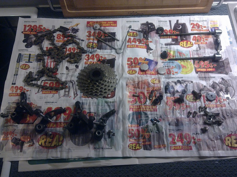

I couldnt wait so today I went to the hardware store and bought some tools. Then I stripped the whole bike down from parts.
I keep the bottom bracket and the fork/handlebars and stem on and clean them up as good as I can. I see some rust from the headnut so I think that if I dismount that I will not get it together again. And it's working good so I just keep it the way it is. Here's the first batch of parts that I have degreased (soaked in degrease and then washed).
The rest I have to take tomorrow because now I have been on it for almost 6 hours.

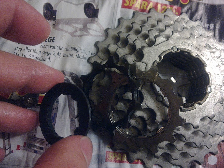

I have one little thing that I am concerned about. When I took of the freewheel the 2 smallest cogs was loose. Is this normal or have I broken it? Thanks
:D
You're OK, the two small rings are loose and held on by the lock-ring. Also I wouldn't worry too much about the rust on the stem head nut as that is quite normal for a bike that age and should loosen without too much of a problem.
