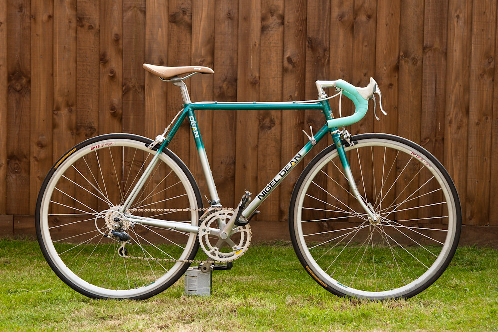

A couple of months back I bought a Nigel Dean 531 frame, not sure of model or age, I'm guessing late 80's to early 90's. Anyone have any ideas?
Just today got chance to finish building it up..
From this:
To this:
Nigel Dean 531 by Hallsy01, on Flickr
Hopefully get chance to take it for a spin tonight, and if I get on with it, I'll slowly upgrade the drivetrain.
Cosmetically I'm after some tan hoods, also new pedals wouldn't go amiss. I think maybe tan bar tape would have worked better, but I went with green at the time.
Will be an interesting experience after years of mountain biking anyway!!

Feels very different, seeing as I've never owned a road bike before!! At speed it feels great, but slow manouvering is very twitchy!!
Main thing is that riding on the hoods feels a little odd, not that comfortable on the hands, and doesn't feel like I'd be able to brake hard/quickly if I had to do an emergency stop!! Do the bars look like they need to come up a bit (in terms of rotation), or move the hoods up further?
Or is this normal, and something I'd get used to!!??

Your bars aren't set up quite right which could explain the odd feeling on the hoods. They need to be rotated backwards a little so that the ends of the bars are directly below the centre line of the top of the bars. Then you need to move the levers further down the bars - this will give you a position that's slightly lower and slightly more extended than the one you have now. It should feel like bar ends on a mountain bike.

Thanks Terry, I had already moved the bars around a little, until the emblems on top were facing upwards, I also moved the saddle forward a bit and it feels much better :)
