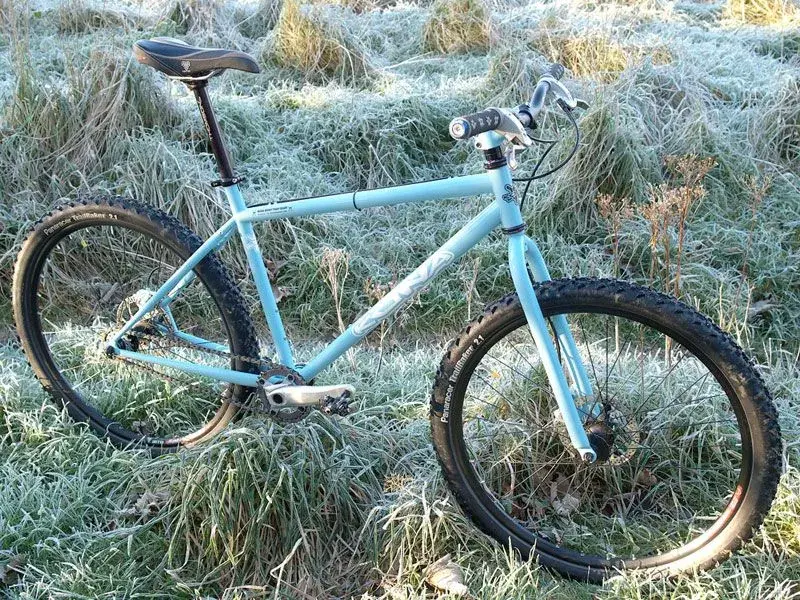

I did wonder about posting this here, as I'm sure someone will question its true "retro-ness" and also because some of you will have seen it before.
This is however probably its final build state (well, for this winter at least :) ) and the only likely changes will be odd times that I use Magura Asgard forks or I find a 29" front wheel to try. It seems destined to be a work in progress...
The only thing that I should have done was braze on a centre top tube hose guide, hence the cable tie :oops: .

Thats great, super clean build 8) 8)

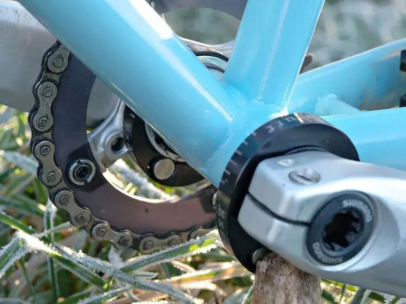

kill him , thats not retro :lol:
how do you get on with the bb ?
what ensures both cups are aligned ?
i asume the bearings are replaceable ?
looks good
I get on with the BB fine - I've not had any problems with slippage, creaking etc. Nothing ensures that both cups are aligned, except by eye, or using a steel rule or something across the graduations. One thing that I will do when I have it stripped down next is drill a couple of 6mm dia blind holes in the outside of the cups and then make a "C" spanner to fit, as otherwise turning the cup on the driveside is a bit of a fiddly job to say the least.
The bearings are standard 6805 2RS - 37x25x7mm.
A good bit of kit but obscenely expensive for what it is - I was lucky and bought mine (unused) from a friend who went off the whole SS idea.
If you are using XT cranks you have to machine off the granny ring bosses for clearance.
