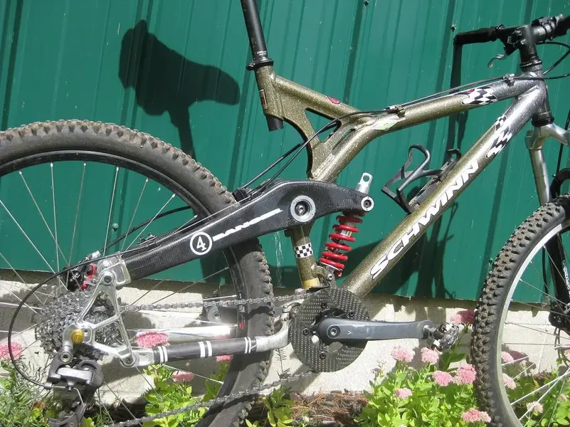

So after I built up my 2001 Schwinn Straight 6 http://www.retrobike.co.uk/forum/viewto ... p;t=189580, I found that the medium frame was actually a 16" that translated to a-bit-too-small for me. It rode nice and handled well, but felt a little cramped in the cockpit compared to my GT i-Drive 3.0. Fast forward a year, and I find myself in Northeast United States and back on eBay looking for bike bits:

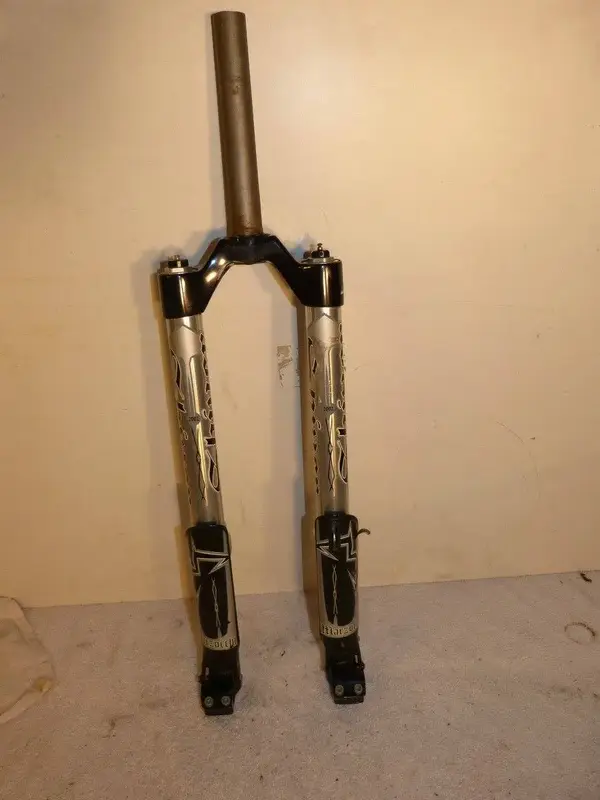

First was finding a 2002 Marzocchi Shiver SC located a town away - the catch was that it was missing its (unique) front 20mm axle. One of the last places that still had one was Hibike in Germany - duly procured for $90.
Next was the Schwinn frame itself in Bassboat Gold - 19 inches so it might run large, but other built-up HGs look about right for me. It came with most of its M952 XTR groupset - cranks, BB, derailleurs and shifters and a Chris King headset. I totted up the sums (M952 cranks alone went for $150 on the 'Bay), mulled it for three days before pulling the trigger after a couple of stiff shots of Scotch.

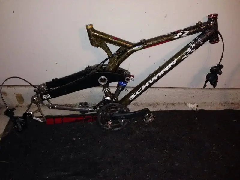

I received the frame today, the shock is practically bespoke to the frame as it has the mounts machined as part of the shock body. It measures 5.5 inches eye-to-eye and is not travel-adjustable in this guise. The condition is beautiful but I can't build it just yet. Its likely to eventually become half of a his and hers pair of Schwinn Lawwills.
As it was filthy I had it washed and scrubbed down - the XTR bits were nice and the Chris King headset has a nice Homegrown Tomato top cap. When it dries I will do a proper look over and take some photos.

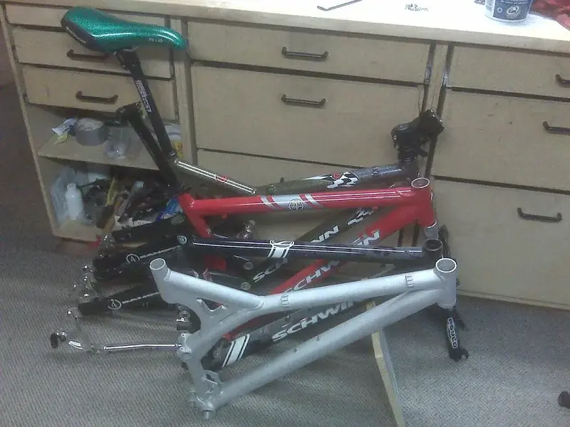

The Fox trunnions are impossible to find, I've been looking for years.
I have the same HG frame and used a 2" stroke Rock Shox on the rear with the trunnion from a broken standard 4 banger frame to make it a straight 6. The main downside is being at the limit for BB hight adjustment, the bike needs at least a 5" travel fork to have a reasonable head tube angle. My 5" Psylo dies so right now have a 4" Reba for now which is sketchy.
You can get an adaptor for the rear brake to go from 22mm to IS. Then use a front IS brake caliper to keep the 160mm rotor. Otherwise with a rear brake caliper and that adaptor you would need a 180mm rotor which may not fit in the frame.
If you plan to ride the frame a lot I suggest collecting spares when you can, they are fragile. Although the HG frames do tend to hold up better.

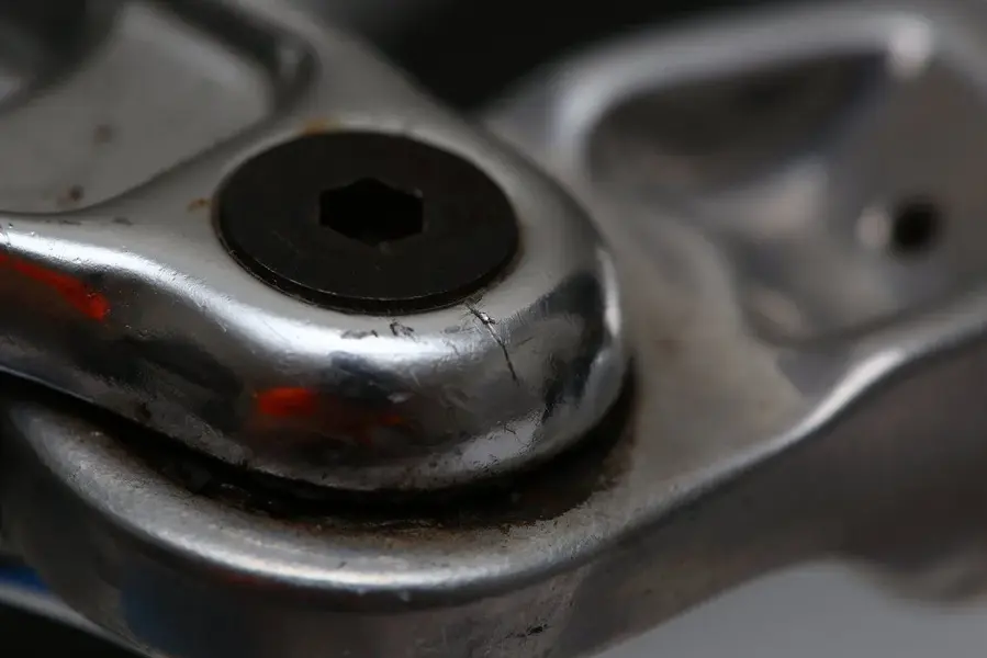

The 2001 Straight 6 I have seems to have a much burlier front triangle. I found a crack forming on one of the right side drop links. Its not made it all the way through but it is growing from an odd spot, not where I expected it to form.
The chainstay yoke itself is in good condition, scuffed but no cracks that I could see. The pick up points of the front triangle look fine, too. It does not appear that this frame was beat on; which make the crack even more perplexing.
The pivot cartridge bearings all need to be replaced though. They feel gritty. More as I dig in......
