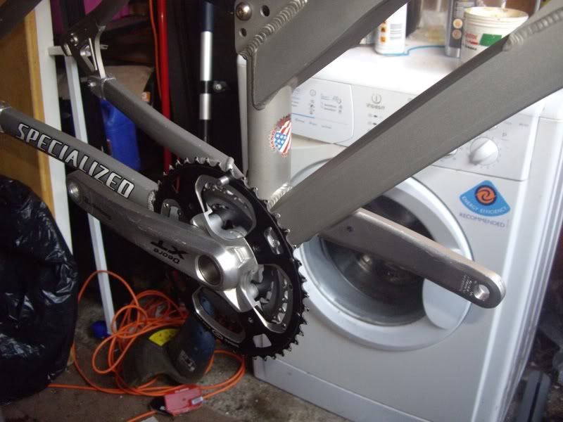

Then took to cleaning up the crankset and installing BB:
Hollowtech is a new one to me, but seemed easy enough to fit. I would like to know if i was using the right allen key for the allen nut (i have an orange goldtec one) didnt seem to fit as snugly as i expected.....is there a reason for this?

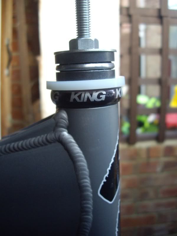

next came the headset - i made my own tool for this. got some thrust washers from a scissor jack (ebay), fitted with some nylon washers. slides the cups in nice and gently :) was a bit nervous doing this, but seemed to go in fine :)

Looking good! Just wondering, is the biggest chainwheel not 90 degrees turned? I thought the little pin on the outside should be behind the crank.

i did wonder this. didn't take a note how it was before i took it apart...:oops: how might one find out the correct positioning of the chainrings...??

The pin should be under the crank. It prevents in case of a chain that falls to the outside that it gets stuck between the ring and the crank. Having it turned 90 degrees also means that the shift pattern are off.
Easy repair! :wink:

the orange bolt should be done hand tight,1st then the 2 bolts on the crank arm should hold it all in place
im assuming you tightened to 2 bolts 1st then the orange on to lock it

I like your headset press, well done!.

@bigmick- i guessed what the orange bolt does so did that first then the 2 crank arm bolts :)
