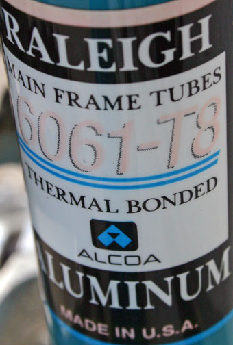

It has this 6068-T8 aluminum type of tubing. It must look like a Technium. I am in the USA, it may be a Raleigh USA bike or maybe it is made in the Far East. To me, it sounds sort of appealing. It is a blue bicycle. He sent me pictures but they are a bit poor. It has 7 speeds and I believe is outfitted in Suntour Radius! I didn't care to push him too much on the issue. A number of paint chips on the chain and seat stays but otherwise, seems to be in good condition. I mention the paint chips because there were a number in the back area. I don't know how aluminum tubing holds up over a long period of time and if this is potentially a "red flag."

Without knowing much about this specific model - aluminium is fine probably upto 15-20 years if it's not been smashed bashed and abused. The Techniums were bonded, I'm guessing this is welded. Check around tube joints for cracks or wrinkly paint, look down the sides of the bike to see if it's straight (measure rear dropout to front dropout on each side with the bars straight ahead - the measurements should match!) and feel under the top tube just behind the head tube for lumps and bumps. And make sure it fits you - the wrong sized bike will never make you smile.
