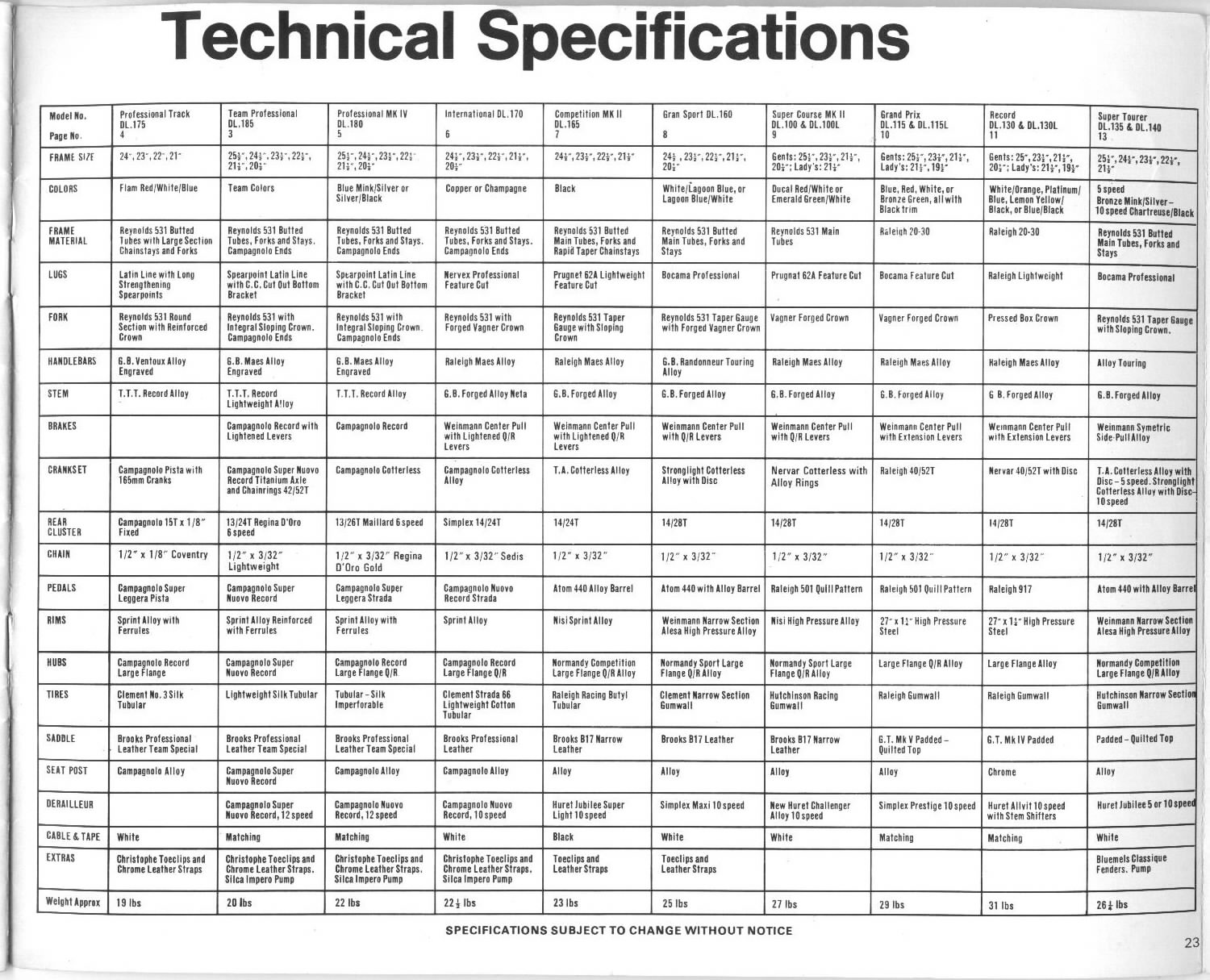

The 4 in the s/n is for 1974. From the brochure:
