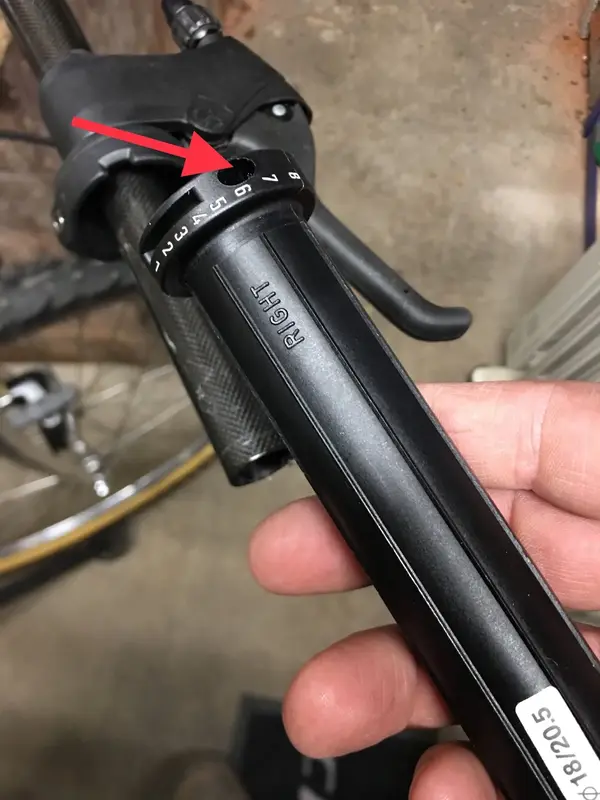

Here we go....
The unit is fully fitted as per the instructions and operates fine, if I twist back this pulls the cable therefore pulling the mech towards the centre line of the bike (from smallest cog to largest on the cassette) the only thing wrong is the indicated numbers.... think I’m gonna ask Gil to knock me up a bespoke vinyl set of numbers descending to stick over the originals...

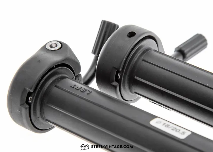

First thing to note is the word ‘RIGHT’ Is wrong way around which suggests it should come out of the other side of the indicator. Or is this a continental thing like brakes where it should be on other side?
Odd though. Just thinking out loud.
Or is it for a funky reverse mech type can’t remember what they’re called
Peachy!":dca1pbcu said:
Here we go....
Your explanation makes sense to me, and I would agree that the numbers on the Shifter are reversed. The big surprise is that the instructions also indicate that the numbers are reversed :? .
Quote,"Assemble of the cable: Place the Shifter on position 1 - Insert shift cable". Surely with a Normal Rise Mech, it would be on position 8, Smallest Sprocket, furthest from the centre line of the bike. Blimey, our Italian cousins eh :LOL: .

I think you have them on wrong, other pictures I've found have the indicator windows toward you
Give me a mo or two
