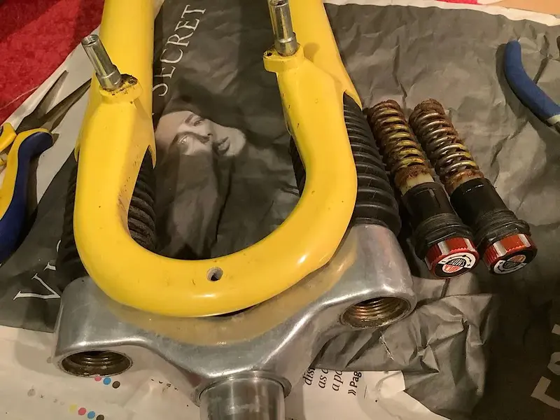

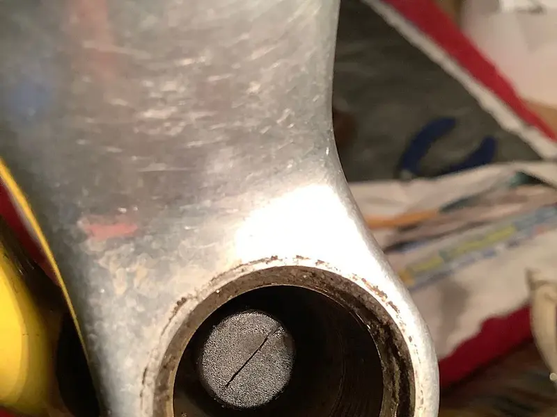

Trying to overhaul a pair of rockshox Indy sl forks... top caps came off easy, springs came with them, but the rest seems fairly well stuck inside. Any tips? Have tried grabbing the plastic with pliers but they don’t really want to go anywhere...and I’m a bit nervous about chewing up the soft plastic if I try too hard...

Used Indy's for years.
They are straightforward to service - if maintained properly.
I've seen similar when i raced/worked for a bike shop - the general theory (i have no idea if it's true) was that if the wrong lubes were used the travel adjusters 'expanded'.
It seems that some lubes can be absorbed by the plastic.
When i say expanded, we are probably talking about very small amounts, but enough to stop you being able to remove them.
We only ever used Judy Butter or Buzzys Slick Honey when servicing suspension because they don't have the unwanted ingredient that makes plastic swell.
On forks with this problem the travel adjusters were always removed eventually, but it wasn't pretty (i won't provide the gory details).....
And the travel adjusters always needed replacing - easier said then done in 2019.
Not sure any of this helps, but that was the school of thought in the 90's.
Thanks, good info. Basically confirms my thoughts that it’s probably not worthwhile going any further... I have a surplus of forks anyway so will probably eBay them for spares/repairs. May be of use to someone. Hope so!
