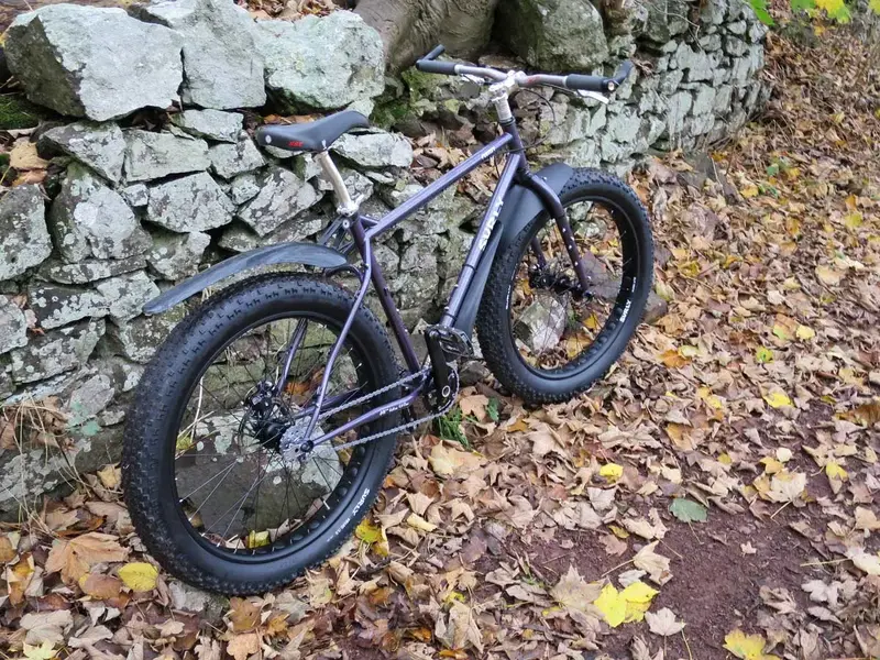

Barry, a discussion was had about a fat bike, there was a lot of general amusement until I pointed out a lot of you lads in Scotland used them seriously off road, oh and by the way some were single speeded....sniggering stopped at that point....
Re: Re:
Indeed, it is true, but that one above is not my ss one.

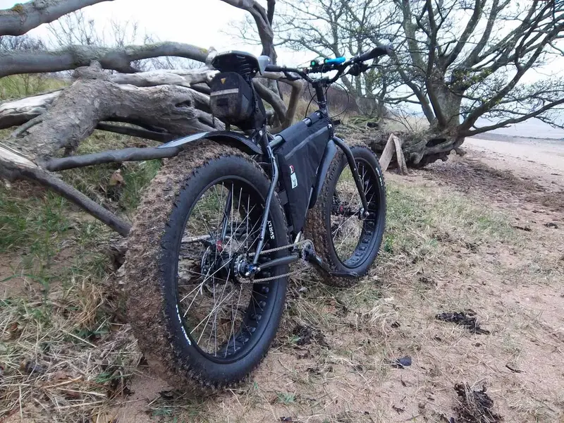

This one is my ss one. :mrgreen:
