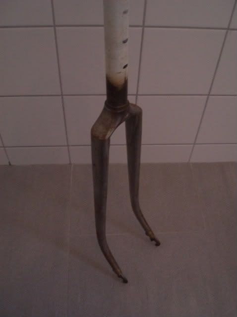

Thought the forks may have been non original (fully sloping seem a bit modern for this bike) however the number on the frame corresponds with the number on the steerer

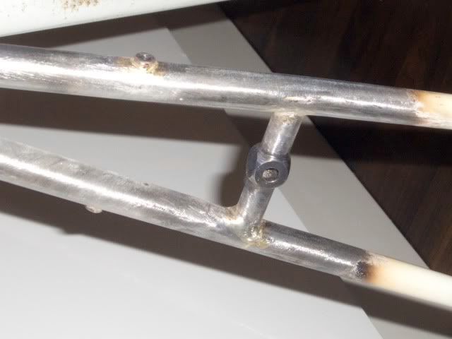

First job is to have the centre pull hanger removed, guessing i'm going to have to change the mech hanger to (simplex dropouts)

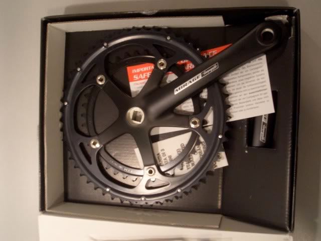

Going for Mirage on the drivetrain, seems to be some real bargains out there at the min plus i'm going for an all black look 8) Regarding brakes ideally I would like to fit some athenas in graphite

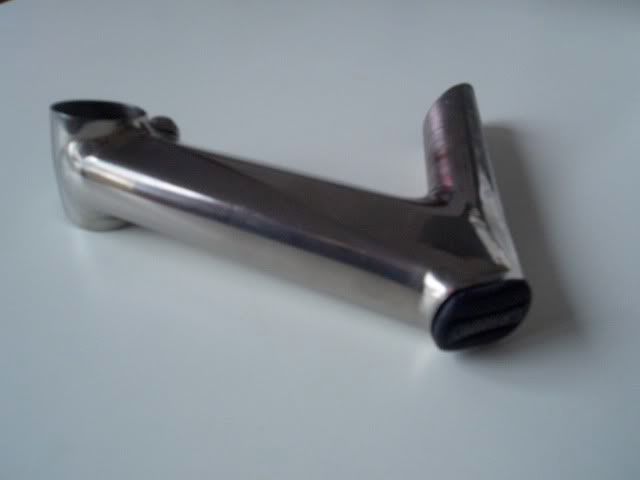

really pleased with the stem, lovely piece of kit, the font on the rubber cap is cool! 8) no major marks although the lower part has quite a few scratches but these shouldn't be visible when its fitted

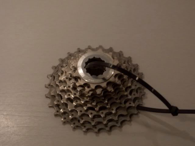

dura ace ti cassette (will be using shiftmate)
not bad for £18 delivered :D
can anyone tell me what size crank bolts these use? ideally i'd like to replace them with something darker

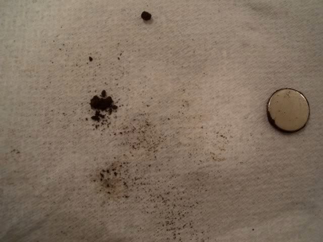

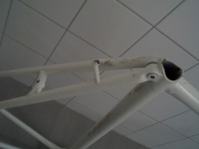

sounded like there was a ball bearing rattling round the top tube, used a magnet to get it out (through the gas release hole) came out in lots of small bits havent got a clue what it was :?

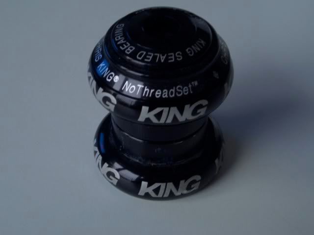

I've got a 1" King gripnut headset in black if you're interested in swapping the relevant top bits?. I can always use another 1 " aheadset!

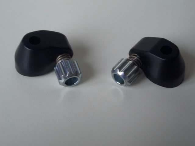

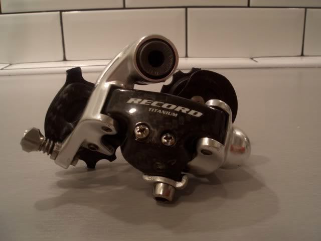

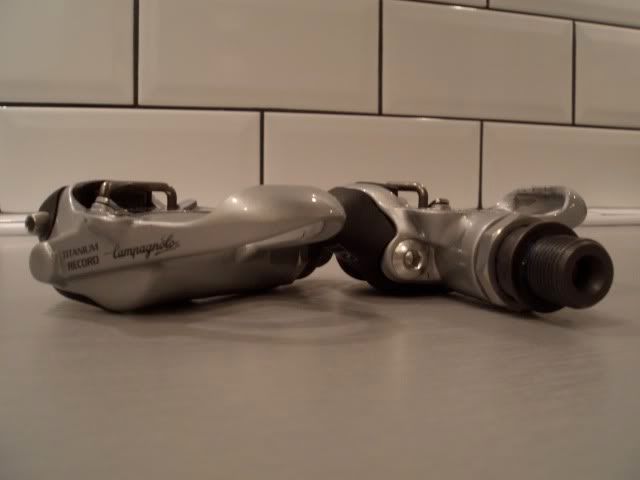

more goodies :D

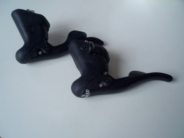

Went to the manchester bike jumble last week found this record chainset going cheap so snapped it up, think i've made a rod for my own back now though as i'd like to go for record mechs and shifters now :(

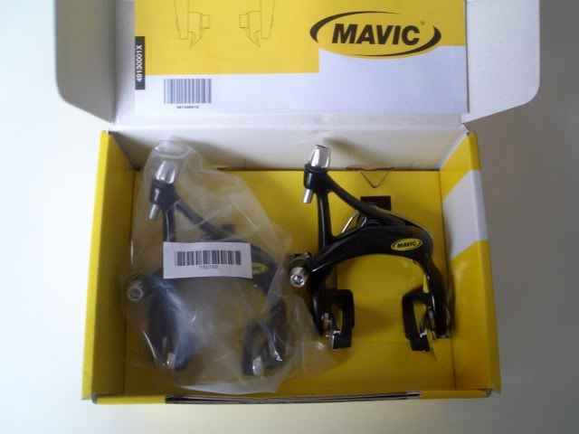

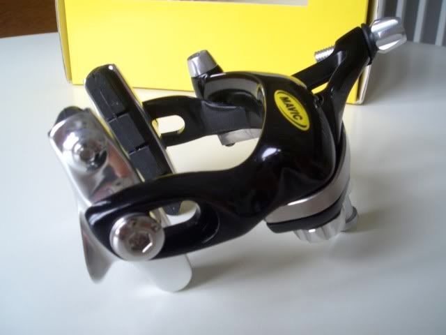

brakes

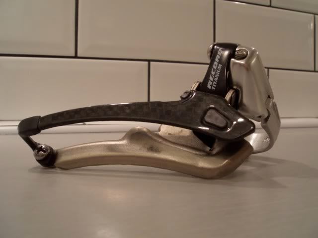

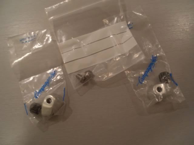

More campag bits

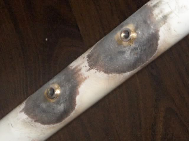

Got the frame back today sorry for the bad pics (even worse than usual) going to the enameler tomorrow so had to grab some pics quick

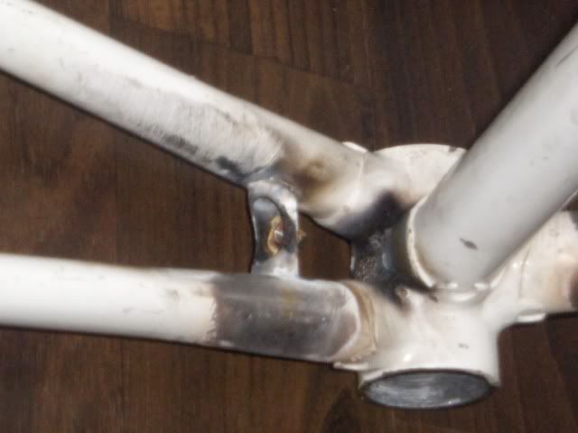

New brake bridge and rack eyelets, may wish to add a rack in the future so it made sense to get them fitted now

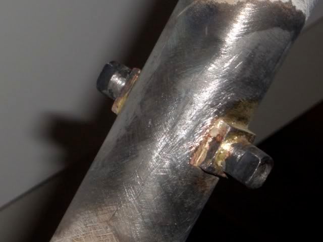

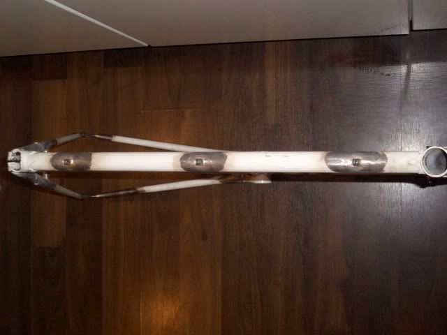

down tube shifter bosses
bottle mounts
cable guides
new dropouts, kept them vertical for ease of getting the wheel in and out
bridge altered for mudguard
