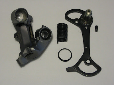

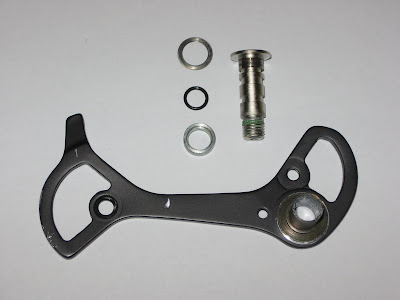

I have done the same.
But be aware, the tension on the springs can be high. When taking out a bolt keep the parts pressed and gently open it, because the spring will come out.
It takes a few times to fiddle with the springs to bring it back together.
If you don't have any patience, don't do it :D

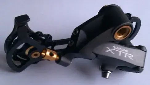

Where did you get the gold cable barrel and the mech bolt please,great little rundown as well.....very handy :D
I buy those kind of bolt from eithe Jersey Cycles or Toronto Cycles. They are if I'm not mistaken brothers. And they have all sorts of bolts.
These bolts are matt gold anodised, I actually wanted shiny gold to mount them in my polished Anniversary M952 edition. But they turned out matt so I mounted them in my matt grey M952. Looks very nice if I may say so.

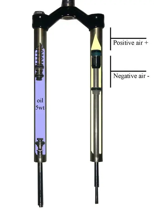

But I'm now working on overhaul pics for SID's for my website.
Like this:
