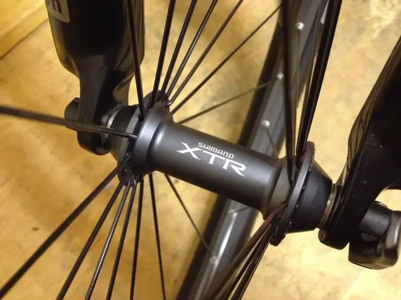

Ive an M950 wheelset,radial at the front and semi radial rear(non drive side).Zero problems.By far Im no expert but I believe its not advised to go full radial on the rear drive side.
No problem :cool:
