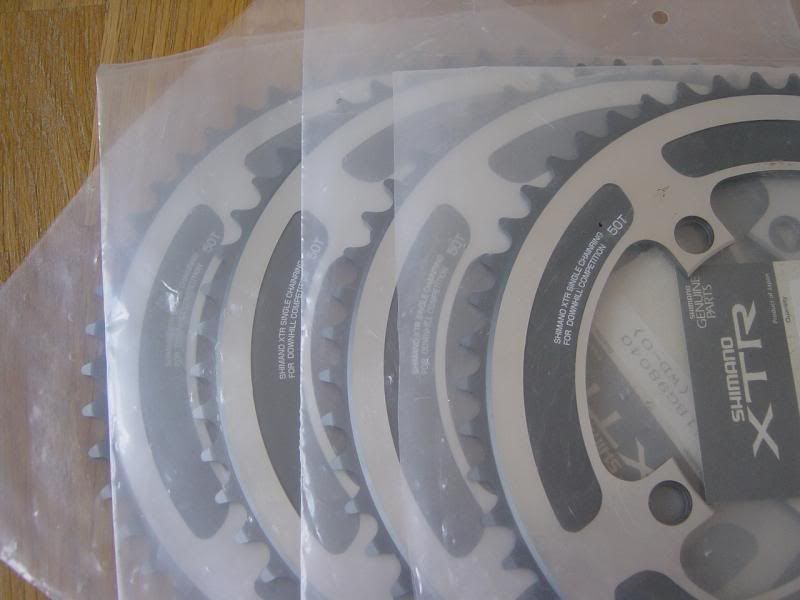

Yeah my four bolt XTR DH is 112mm ?!
That's why I bought a few rings as 'stock' :lol: I have a spare one if anyone is interested ... ?
