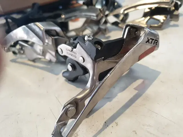

I'm after a M950 front mech. Had my eye on ebay for a while but everyone seems to be after top money for rough ones. Doesn't have to be 950, can be a variation on it like 952, etc.... Must be 31.8 and bottom pull and in reasonable condition. I see a fair few for sale with the chrome plating coming off, I can cope with slight pitting.
I have a very tidy m953 in the larger band size. You can shim it to fit. I may have one somewhere.
The back plate is aluminium, and the chrome lifts very easily with time, wear and corrosion.
This is why good condition ones are rare expensive, and rough ones are common.
It's a build style shimano didn't continue.🙄
I think there's a trick to flipping top to bottom pull
This design suffers pivot wear too, making selection for the small ring tricky; even straight out the box it wasn't always good.
If it's for a rider, and you actually need three rings, you'll probably need to go as mint as possible, or NOS.
I've given up buying used f/mechs as usually they seem to be for sale because they're shot.
I have a 953 in really nice condition which was going to be for a Specialized I could use. The one I want is for a GT and ideally didn't want to shim it. The bands are quite slim on the xtr so didn't want excess plastic showing. The bike won't be a rider so more concerned with how it looks than perfect shifting. From what I've seen the top clamp versions seen to survive better than the bottom clamp ones. I don't mind paying decent money for a good one, I'm just not parting with ebay prices for one that the chrome's falling off.
The low clamp (top swing) wears fast, and its inner stop position isn't that close, so if you have an oversized seat tube and a close chainline, shifting onto the small cog is almost impossible without finesse.
Also all the rear wheel crap is thrown onto it and builds up a shelf of filth.
I can't think what the conventional band m95* front mech is - was there even one?
Best left in the past imo.
Fit a 960👌
The 960 is probably a better mech, just cant bring myself to fit one to an otherwise 950 build. If it was a retro that got ridden I wouldn't hesitate.
It's the colour, the 950 is a matt grey, 960 is grey chrome and 970 is bluey grey. I know its being a bit picky but I need it all to match. I wish I could compromise, it would make life easier trying to pick a front mech up.
