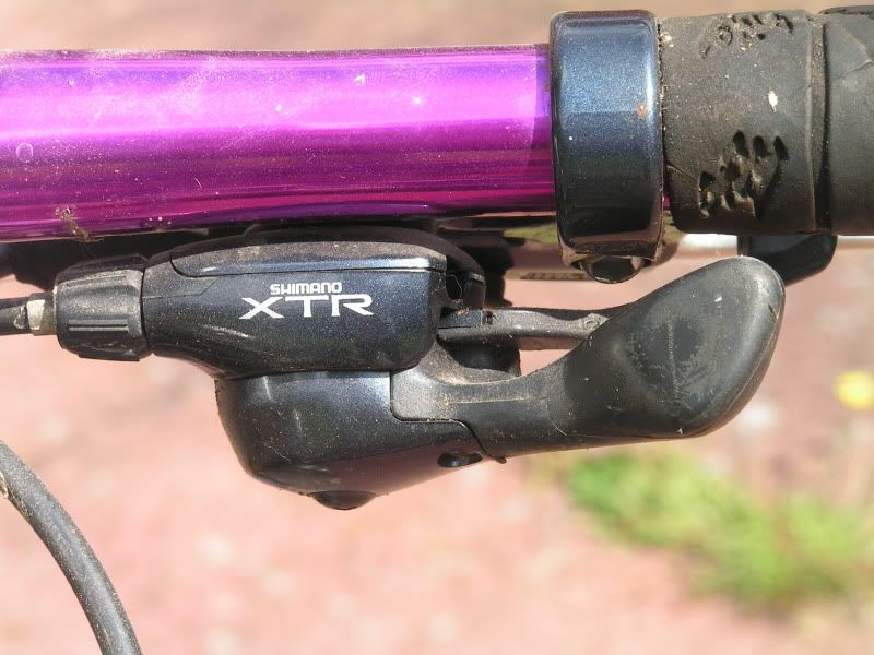

I have some '94 XTR shifter/brake levers but due to my old MRock Shox MAG-21s being totally unservicable :( I've had to get some new forks whchi has also required a swap to V brakes.
Now I've discovered that my levers don't give enough cable pull but been told about something called "travel egents" which I've found on the Bay of E for £20 a pop. Anybody able to suggest anything else before I go spending again?

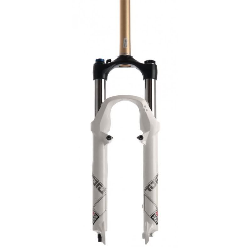

New forks don't allow cantilever brakes hence my purchase of the V's. As shifter and lever are combined I would need to change both which is a bugger.

Pretty sure you can run the shifters on there own (with out the canti leavers), you need to source some stx shifter mounts then you'll just need the v brake leavers.
Why?
No brace or space for a hanger?
No chance of running one of those force-40 widgets (or copies)?
Those are the new forks and as you can see there is no cable mount on there :-(
Like the ide of the STX shifter mount though. Not many on E-Bay though
Try a wanted add you may get lucky or try searching the sales adds, I may have some in the cave will have a look for you tomorrow.

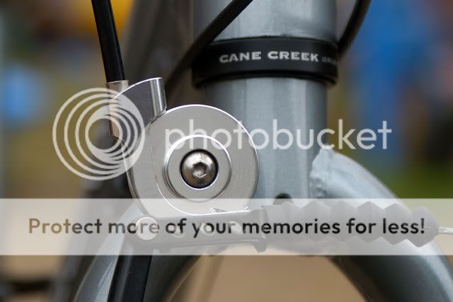

just use the ratio adjustment pulleys that are designed for this exact problem,which work perfectly and you won't have to worry about shifter mounts.
