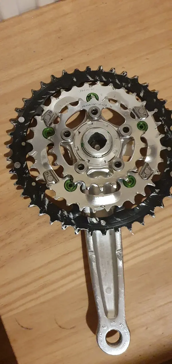

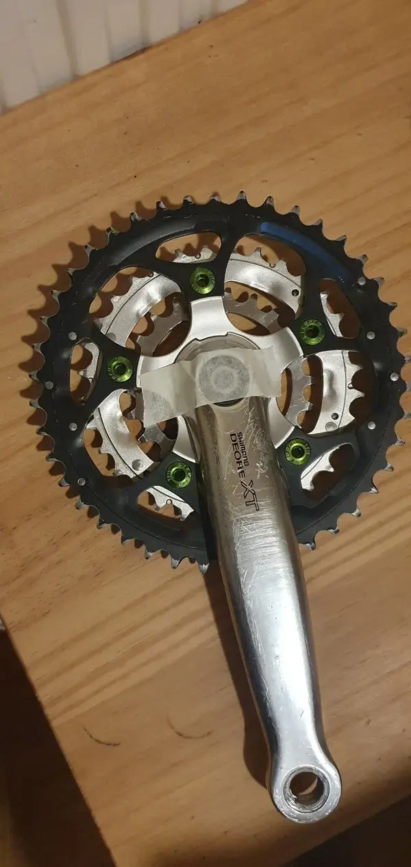

I've got hold of an XT M739 chainset, 5 bolt pattern. The middle ring especially looks worn. Does anyone know where I can get replacements, or what to look for on eBay?

You'll be looking for 94bcd ring in whatever tooth count you want/matching the rest.
Spa cycles do some own brand rings which are great value, very similar to TA rings which are great.
As you have the 5 bolt spider, you have many options really, middleburns are good too.
Check the BCD you need - I have a set of those with the 5 bolt spider and it's 110/74 BCD...
