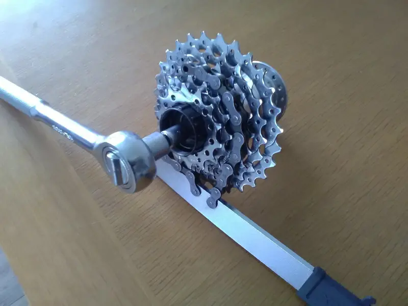

I know what you mean but if you put a cassette on, the chain whip will allow you get enough leverage.
