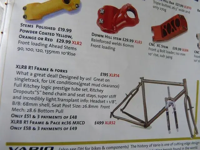

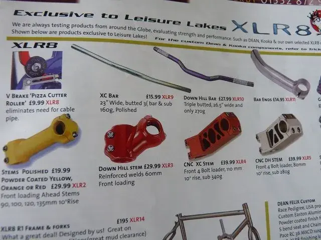

Here you go, not exactly the same as your frame but maybe yours is from a year or two earlier....
I reckon his frame is later, made for V brakes as there's no cantilever brake cable stop.
Well worth saving.
