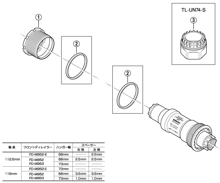

I think it only came in 112.5 or 116 length. BB she'll size, it was designed to run at 68 or 73 with spacers (or spacer/e-type mech combo). You should be able to get away with using your road version tbh. As the m95x versions are scarce, lots have been forced down that route.

The M95x bottom brackets are like the modern HTII bottom brackets in that they are 73mm shell from the start. You then space them out to fit on a 68mm bottom bracket.
You cannot do it the other way, making 68mm wider just doesn't work ;)

See that link I posted above ;)
To simplify. An m952 bb is 73mm end to end and it comes with spacers and is designed to fit both 68 and 73mm bb shells using a combination of the spacers.
