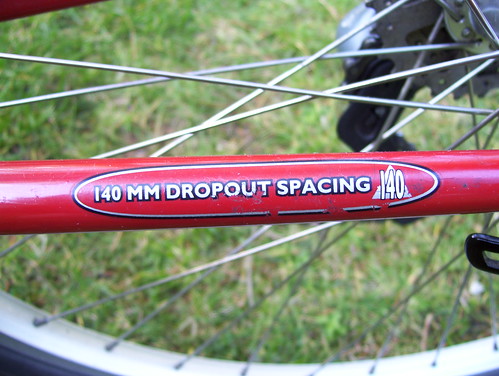

Elev12k":1j0ni1h5 said:Yes, my Phoenix of about the same age has it too
Of course you will need 140mm hubs than. WTB did their own hubs. Very nice ones, with grease guard
They came up with the 140 idea, as cassettes grew wider and wider, resulting in wheels with more dish. With 140 a stronger wheel.
Elev12k":2z3vsszo said:It is from when 8s was introduced. 8s used same spacing as 7s, so spokes moved inward on drive side, resulting in a less strong wheel. With 140mm width they intentended to undo that.
uno-speedo":u27mu0e9 said:you can use a king 135mm hub with a 140mm end cap.
uno-speedo":39krmofw said:i have a spare new CK end cap if you need one. discount RB price of course. my rear spacing was 137mm....so i ended up using a 135mm hub.
