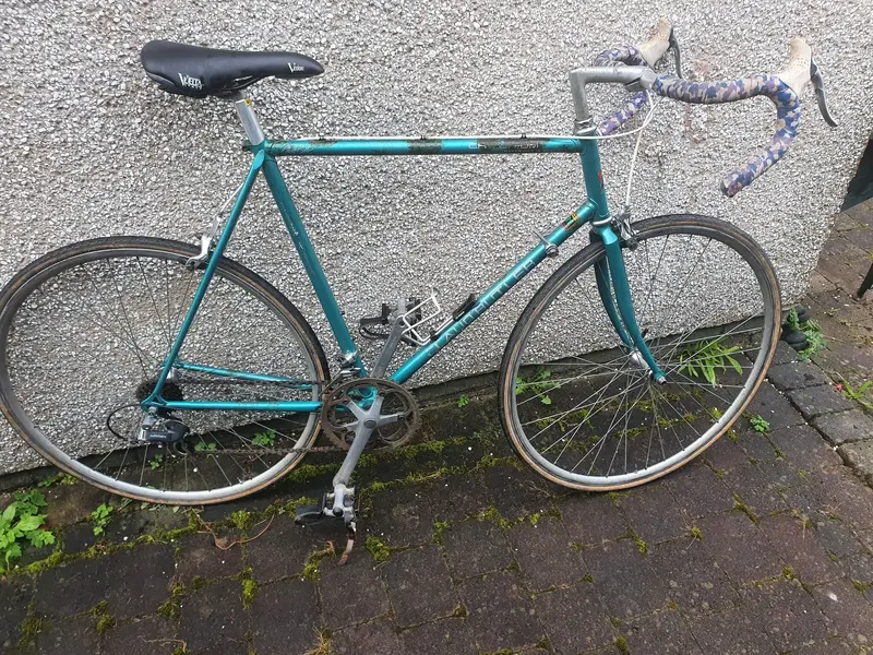

A friend has given me this to bring back to life and keep. it was the bike he had when we cycled together. After much fettling and a ton of wd40 I pumped up the tyres and carefully cycled it round my cul-de-sac. Everything pretty much worked after a wd40, taking off, cleaning and putting on again. Chain works but after cleaning is still very rusty. Bottom bracket seems ok. Cassette cleaned and put back on. However the brakes are sticking and the seat post is stuck. The gears are click ones when you change and no bother going between them and the rings when I rode it. Tested a small bit of rust with tin foil and wd40. Going to need something more abrasive but small patches came off ok.
List of jobs so far is;
New decals - find website
Remove rust but what with?
Change to white bar tape, detergent clean the white hoods
Brakes jamming so probably need new cables
Break chain, clean in paraffin and put back on with magic link?
White wall tyres are already ordered
True the wheels as they have slight buckles
Find retro gear and water bottle
Refurbish toe clips
Any suggestions or tips are would be very welcome!?

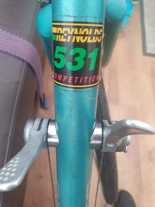

Just out of interest, does the Reynolds sticker say just "531" or "531c" (competition double butted)?
1996 version
1998 version
Thanks for looking out the attached pages, which I've saved. The frame sticker states 531C, which you are thinking the frame model is made (double butted) stiffer for competition in criteriums!?
