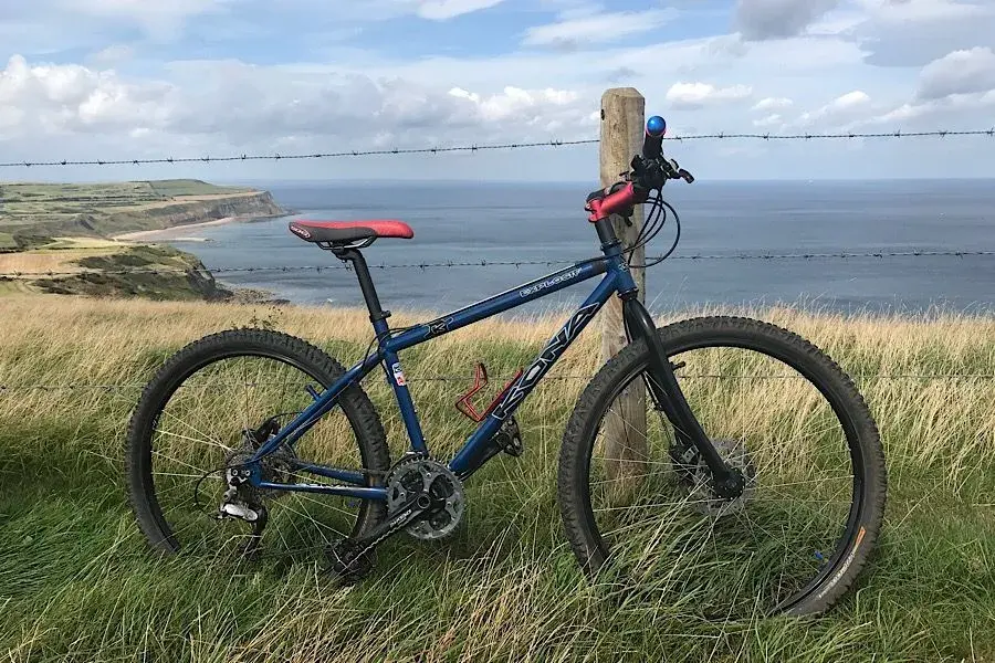

The boss has been told she has some issues that will benefit from 30 mins of exercise a day so the search began a couple of weeks ago. I found on here a 17" 2004 explosif in preston so hot-footed it across the Pennines and picked it up. A well used but not abused bike set up for commuting and also as a boat anchor it seemed. On the luggage scales it came in at just under 15 kilos :shock:
A bit of a strip (it all worked well despite the grime) and a little THM type adornment and we were ready to go. Down to 12kg already. A short trip up the hill behind the house via road and footpath brought us to the photo op.
She's happy so i'm happy.

Thinking red panaracers would compliment the accents.

Red Panaracers could look good... But... it's not going be another's Triggers Broom is it???
Based on my ladies requirements (she doesn't ride often) she wanted something comfortable (decent sus forks) and fast rolling so it's easy going and as she won't use her bike in the wet and she won't push hard tyres can be quite the faster rolling ones with the lighter carcasses.
I'd go with some Schwalbes and use a racing ralph on the rear with a rocket ron on the front. Get the evo folders and not the cheap wire bead ones. They are far better than the Panaracers (I took those off and replaced them with a Ralph/Nic combo and it was miles better) which are a really old design and will hopefully encourage her to get out more. Definitely function over form though. Once she is coming out more often she may want some front bounce so be prepared to have change that.
I think at some point i'll be converting the wifes Cube to 1x transmission as she doesn't get gears and is forever in the small/small combo so having just the one shifter with a wide range cassette would be better for her. It will also save a chunk of weight too.
Liking the simplicity of less gears. The conti vapours are fairly fast rolling and give her confidence off road at present.
