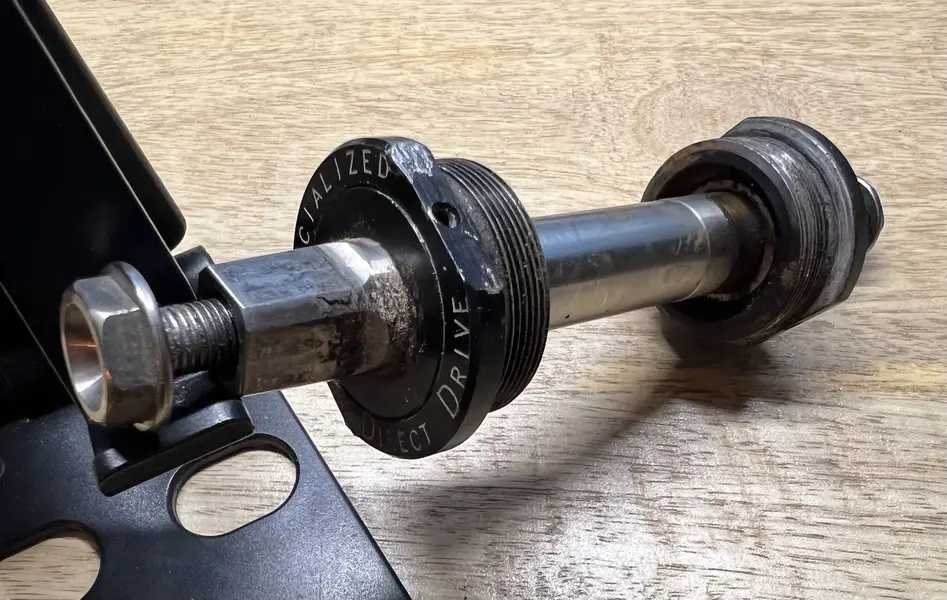

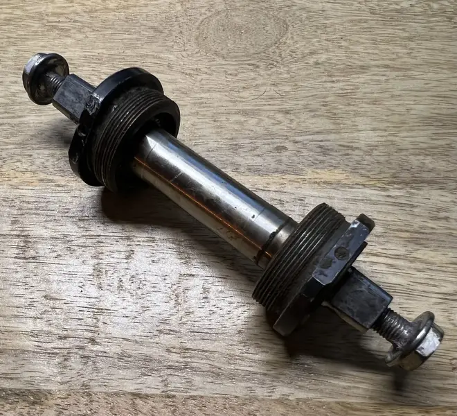

@Swede do you have one of these?
They are nice I have one and it's counter-rebrand Specialized one.
It's called the Phantom and came silver, Specialized called it Direct Drive, and would be black.
Sorry, missed this. Yes, I have one one the B5 and used to have the Specialized version on a Funk.
